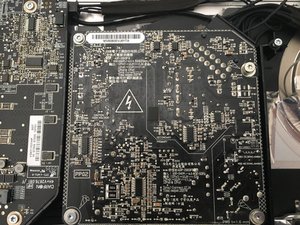

Power Supply (PSU) pin-out diagram
I’m looking to try to drive a non-Mac Mobo off this PSU. I need a pin-out diagram. I see one for the Mobo end of the 2389 version but I don’t have that iMac, and I can’t check which Mobo pins connect to which PSU pins, so it’s useless to me.
Anyone know where I can find a pin-out for this actual PSU (the label on it has the part number 614-0445)?

The PSU is a Delta ADP-200DF and a search on that may reveal more. In the meantime, I would use the pins listed for the test points. Use your multimeter to measure those on your actual PSU:
Pin 1
Ground
Pin 3
5V power for Hard Drive(s). Note: If present, the 12V power will come directly from the Power Supply to the Hard Drive thru the power harness cable.
Pin 4
Standby 12V power (permanent power coming from power supply, present as long as AC cable is connected, even if computer is off)
Pin 6
Backlight Control pulse width modulated signal (from logic board to LED backlight board, to adjust the backlight level setting according to user setup)
Pin 11
12V Run-Mode power to logic board (coming from power supply, present as long as system is on or asleep)
Pin12
Power On Request signal (from logic board to power supply when power button is pressed)
Pin 13
Backlight Enable (signal from logic board to Backlight Controller board, to enable backlight)
Pin 1 should be marked on the board. If you have any difficulties with that post some images of your PSU with your question. Adding images to an existing question

The voltage on the power supply board is like the photos I attach
im struggling with the numbering of the pins the one at the top is number one and moving on down the line going from left to right is 1-7 ? Any help would be greatly appreciated
@ghostman top of the bottom aera is 1. and bottom of bottom is 8
Could anybody show a picture how to connect e.g. a HDMI driver board to the PSU? How can I use the 12V output from the PSU and where would I attach a cable to it? From the images provided, I can not figure out how the PSU could be used for that purpose.
@huedrant what exactly are you trying to do?
@ciutucvaleriu Thanks, that's helpful. So now I guess I need to solder some cable directly to these pins on the PSU?
I thought I could just clip two cables that come from the PSU and then solder those together with my HDMI Driver board.
From what I see in the image from the other thread you referenced, this might be PIN 8 on the MB connector that carries 12V when on https://guide-images.cdn.ifixit.com/igi/...
But no idea how to proceed now…
@oldturkey03 well, I want to power a board that I planted inside the iMac housing with 12V from the iMac PSU (after removing all internals in the iMac except PSU & the display itself)
