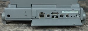

Here’s your systems ports
Apple updated the 160 with color with the intro of the 165 which offered a Mini-15 display interface. I don’t think you can find the needed cable for it.

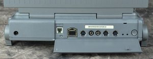

And here’s the 165c ports
@danj I found them (but it's a hard find), but I made a mistake and assumed it supports it like the 170/180. The Vid14 cable is sold under M3927LL/A. I'm not surprised it flopped since composite is less then ideal, but that was it outside of not having a second display.
I did some research on it, and Apple had FCC compliance issues at the time more then once. They had to recall the Apple III because they had trouble with the original. It's more of an issue on the desktops then portables.
@nick - This is the correct cable its Mini-15 to DB15 which can then plug in a VGA adapter Video Cable. Back then NEC & Sony where using the DB15 connector which predates the VGA standard.
