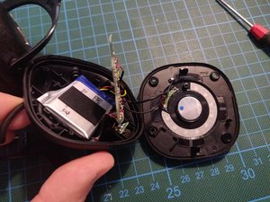

THE BATTERY
Above is a picture of the battery of a Marshall Mid (bluetooth). From the thread I linked, I understand the importance of correct dimensions and voltage, along with how to find these. I’ve looked around on the web and found this:
'''Would this battery work with the Marshall Mid?'''
I read in the other thread that the three wires are “negative”, “positive”, and “ground”. I kind of understand “positive” and “negative” (as all batteries have these), but I have no idea what “ground” is, and all the battery in the link tells me is that it’s got a “thermistor” (which some Googling did not help me understand in regards to this question).

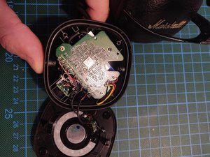

Hi @mjennifer ,
The ground wire is the black wire from the battery (-ve terminal) and is connected to the GND terminal on the board. Ground is just a common connection and reference point used within electronic/electrical circuits.
The supply voltage is the red wire (+terminal of the battery) which is connected to the VBAT terminal on the board.
The yellow wire from the battery which is the temperature sense wire is connected to the NTC terminal on the board. There will be a thermistor already connected to this wire in the battery .
The thermistor is a Negative Temperature Co-efficient (NTC) resistor which is placed on the battery (usually inside the wrapping so that it actually makes contact with the battery casing) to monitor its' temperature.
As the battery temperature rises during charging the thermistor's resistance will decrease and this will be detected by the battery monitoring circuit in the motherboard.
If the battery temp rises too much or passes a certain threshold value as determined by the resistance of the thermistor the battery charging circuit will be disabled, preventing damage to the battery and also a possible fire situation from eventuating.

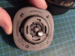

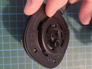

Hi, just wanted to close up this years old thread by documenting that replacing the battery in the Marshall Mid ANC definitely works.
I bought this battery on Amazon Germany: DC 3.7V 800mAh 603040 Wiederaufladbare Li-Ionen Batterie für Marshall MID Major II Major III Major IV Bluetooth Kopfhörer VDL603040 SR603040
Doing the battery swap is as easy as
1) twisting off the ear cushion on the left side (the one with the button)
2) Unscrewing the 4 screws
3) Unscrewing the 3 screws holding the PCB in place
4) Unseating the old battery, which is most likely taped to the bottom by double-sided sticky foam
5) Unsoldering the 3 battery leads, soldering the 3 leads from the new battery (red=B+, black=B-, white=NTC)
...and putting it all together again in reverse order. Everything seems to be working including charging.
Have fun!
