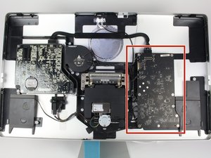

Here is the controller board:
The capacitors on the controller board are going to be SMD as there are no through hole points that indicate that they’re through hole. You will need to use a hot air gun to get these off, as a soldering iron tends to not work very well. I do not have the values, but you can get them off of the capacitors or a reference board.
Thanks for your comment! I had replaced the power supply unit with my another Apple cinema one, but it didn't work. So, my question for you is what is Controller board? I know how to disassemble and re-assemble with new parts, but I don't know how to solder iron. And what is Capacitor in controller board? Perhaps PSU itselt is not the issue neither I think because the Apple cinema one didn't work. Again, thanks for your kind explanation! Look forward to hearing more from you!
I'll add more information later, but I've added a photo to ID the controller board. For now, the thing to remember is both boards have capacitors and that may be the fault.
Aha! That makes sense. So what are capacitors? Where should I solder? I am afraid to do it, but I just want to know. :)
I added more to the answer.
I saw your red mark, yet it is hard to understand what are capacitors. Do I need to solder entire irons there? Or do you think that buying and replacing the logic board will fix this issue? Thank you for your quick reply, Nick!
