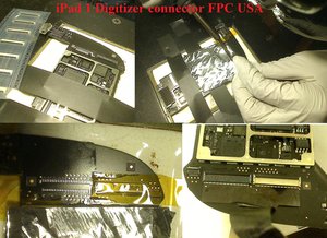

I have done the ultimate sin! I have broke the clips that hold the digitizer ribbon into the logic board.
Now the digitizer will not pick up touch!
The only thing I can do is try to replace the plastic clip that is on the connector.
i have done a massive search of google and cannot find the part without buying a complete logic board. Anyone have a source for these???
I may need more than two because I broke the other one trying to learn how to remove and reinstall!

i ordered two of these just to have a couple onhand - not to resolder the entire assembly in, but just cause this was the only thing i could find that might have the little plastic clips youre asking about..
however, earlier i had a damaged one, with the two side prongs broken off, managed to slide it into place on another ipad i was working on, and with some finagling, got it to clip down onto the ribbon properly..
I also broke one of the digitizer cable retaining flaps while replacing my iPad's LCD. After making sure that there were no pieces of the broken clip remaining, I tried just sliding the digitizer cable into it's housing slot, leaving it unclipped, and hoping for the best.
I was pleasantly surprised to find that the touch screen was accurately responsive about 95% of the time, with only intermittent registration of phantom touching. Of course, while that's better than I'd expected, it's far from ideal.
So I went back in, and used a small piece of polyimide tape in place of the clip, and haven't had any problems since. Of course, this was just a little while ago. Still waiting to see how long-term a fix this is. Worst case scenario, I suppose I could do a little light soldering.

With the mylar tape, you are really just putting bandage on a broken connector.
Depends on how you break your connector and if you bend your pins off tack or not applying external pressure from tape may or may not bring back the touch function with dead spots.
Any strong tape would work really, just don’t use conductive tape that will short out your board. You will have to open the ipad and redo the whole thing again and again over time and hope it still works, because over time the tape can lose strength holding the flat ribbon connector down. The way you shake your ipad from normal usage can also let the tape lose hence undone the touch screen. soldering and replacement of the FPC connector is really the only lasting fix. Its not that hard ro expensive to get it replaced. See youtube videohow to take your FPC old connector off. 20$ if you do it yourself.
And you can get connector repaired here for less than 99$

I used duct tape cut to correct size and formed it in to a roll with the sticky side out.
When the ribbon cable was inserted in the respective slot and the digitizer was put back together, It held and I have had no issues with the Ipad at all.

I fix the problem with a piece of paper (for me a post-it 'cause their is already glue on it) on the top of the conector ! hope it can help you !
regards
I too broke the clips when replacing the screen on my ipad 3. So i cut the connecting portion of the ribbon cable from the old screen that I had just removed and slid it into the slot on top of the new ribbon cable. I cut off the excess and this provided a tight connection and my ipad and works like new. I used a randon piece of ribbon cable to do the same for the LCD ribbon cable. If you need help I will be glad to answer your email. Ergrunt@hotmail.com.

Hi guys, I've just repaired one that had a damaged clip, with enough patience you can re-use the old clip even with both ends broken off (I found this easier than trying to do it with one end still on). If you can hold it in place upright with a pair of tweezers and then plug the LCD in, you can get the clip to stay down. I put some tape over it for good measure and sealed it up straight away.
