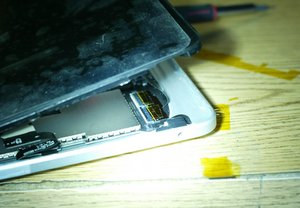

Hello,
I am experienced in almost all Mac hardware,but i am stumped w/ this issue. Any Help would be great!(iPad 64gb Wifi)
I tore down my iPad to replace a peeling digitizer. Upon reassembly, The iPad was working O.K., but the digitizer was locking up and responding very poorly. I decided it must need replaced and ordered a new digitizer through ebay. Now after replacing the digitizer, the touch screen will not respond...
The home button works fine, as well as power/volume/lock.The screen also still inverts. Plus it charges and is recognized in iTunes. I have tried resetting it Via Home+power. Any help would be Great!
UPDATE:
It has been nearly a year now, So I figured it can't hurt anything to try a new digitizer. My Ipad still powers on, resets, inverts, connects to itunes, chargers etc. etc. etc. I have thought about this thoroughly and there is no other logical answer besides the digitizer I received is defective.
When the iphone 4 was new alot of the replacement screens were garbage, and I think it ws the same with the iPads. I originally believed I had damaged the logic board when the retaining clips on the logic board broke off, but after speaking to an electrical engineer, He doesn't believe this makes since. He fixed his broken retaining clips using a thin strip of mylar tape under the tab. I ordered a roll of mylar tape and the entire display assembly which includes the display, midboard, digitzer, clips, etc and a roll of mylar tape for 60$, I will update as soon as I receive the shipment.
Update 2:
Replaced the digitizer again, and no change. As a conclusion, this board is fried, and my iPad is a useless paperweight... I would not recommend buying a logic board for one of these, it's just to much money compared to an ipad 2 16gb. It is really unfortunate, Everything works software and hardware wise, but the screen just doesn't respond to touch. You may be able to salvage some of your loses selling it for parts on ebay.

What I did personally, which seemed to be a good "Permanent fix" was i purchased a roll of 3/4" mylar tape off amazon for about $8.I cut a thin strip the same size as the ends of the digitizer ribbon cable, then I attached it to the top (Opposite side of the gold on the ribbon cable). What this did was create a spacer between the ribbon cable and the socket it fits into, making it harder for the ribbon cable itself to come loose.
If this doesn't make sense let me know and I can email you some pictures!

I am referring to the poorly designed retaining flaps located on the logic board itself (that hold the digitizer ribbon cable in place). These retaining flaps are "supposedly" designed to only be used a few times, similar to how the pentalobe screws on the iP4 are meant to strip easily.
To anyone who has had these flaps break off, I can vouch for using mylar tape to hold the ribbon cable in place.
The digitizer clips, for the frame, almost always need replaced. i finally figured out how to get the digitizers off without breaking the clips. The first few times I removed a digitizer, the clips were a total loss.
O.K. now I understand. I somehow missed that you were referring about the retaining flaps for the dig. cable.

If you look at the part that connects the ipad to the digitizer (like where you plug the ribbon in at) the little black piece, that's on the ipad, has a tiny little clip on each side of it. If you have ever replaced a ram stick in a laptop or pc, it's the same concept basically. They're f'n tiny on the ipad though. When you initially pulled the ribbon out, the clips don't come undone or even hold it in for that matter. Every thing that plugs any ribbon in has them on it. I just unclipped them and the ribbon slides in just a bit more and clipped them back shut. Apologies for the lack of proper names for everything, guess i just don't care enough to learn them, haha....
This was the fix!

I just wanted to report back to all the doubters and the hopers alike: The mylar tape fix worked!!
I used the method described by previous posters: get some mylar or kapton tape off the internet. I bought from amazon. I paid about $10 shipped. I could have gotten it cheaper, but I wanted it as fast as possible. Make sure you get the one that specifies that it is an insulator because otherwise you may end up shorting together some of the pins on the ribbon cable. This take will act as a spacer, pushing the contacts on the cable against the pins on the logic board. All I did was attach a tiny piece of tape on the back side (side with no contacts) of the cable. I covered the entire back including the little dotted white line. That line has to be almost completely invisible (obscured by the connector on the logic board) when the cable is fully inserted.
TEST IT BEFORE YOU CLOSE IT BACK UP!
If it's not working, you either didn't put on enough tape (you can see on mine it took two tries), or you need to push the cable in farther to the connector. Be gentle! And good luck! don't give up, and fix it yourself! I ended up with a fully functional $40 ipad!

Yes that is the same problem anthe Same solution will work. I still recommend Mylar over other options due to risk static shorting. Good luck!

The correct tape to use for covering those copper traces is called kapton tape. The chemical name is polyimide tape. It's an excellent electrical insulator and very thin. I'd try replacing that tape with kapton--it comes in various widths, so you can buy some thin enough that you won't have to trim it to run it down the sides. If that doesn't work and all the visible traces are covered, next I would try the various software solutions out there, the simplest of which is to do a soft (or if that doesn't work, hard) reset. After backing up everything, of course, if you can do so without your touch screen working...
Cannot see the problem with scotch tape, the tape is on the non-conducting side of the ribbon cable and with the small surface area of tape used I don't believe that it will build up any significant static charge.
