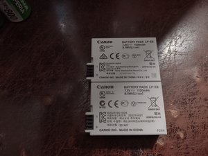

This is an EXCELLENT EXAMPLE of why I discard used batteries:
Both are from 2014 so likely original to the camera and one of them is either a Korean import or a high-grade knockoff meant to pass as a Canon battery. Nope nope nope, they're already from 2014 AND one is suspicious. Now yes, I may need to keep these for the return period but once that's over I can discard them without consequence. I may run the real pack-in 2014 battery until it's too old, but I will not be using that knockoff.
I also recently ran into problems with an a6000 which came with 4 batteries (3 clones/1 OEM Sony). One of the knockoffs swelled in storage outside of the camera so I was able to catch it and mark it as bad; there's a 2nd one that may be going out I no longer trust being a knockoff with similar failure signs. 50% dud rate and it's on the cloned packs. Why in the world would I trust these things when the camera itself wasn't cheap? I'll run them until they die (and note them as coming from THAT camera) but no way would I take them out unless I was using it as an emergency spare with my 50% problem rate and it's just the clones!!!
