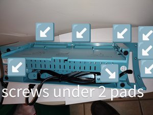

I recently got the scotch laminator tl902..the sheet was jammed so,I opened the machine and removed the jam..But, now unable to assemble it back..Any step by step instructions with pictures would be great help

Here’s a link to the ifixit Scotch TL901 Teardown guide, which may be of some help
You may be able to reverse the procedure to re-assemble the laminator.

Here's a picture of where the TL902 bottom screws go.

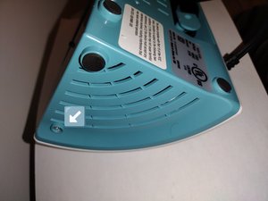

Here's a picture of the one TL902 side screw location.
