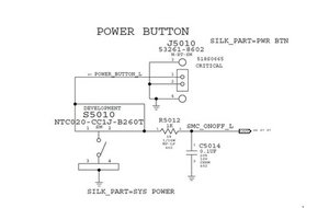

the connector is a Molex 53261-8602. Here is the schematic of how it is connected and “wired”.
Looks like connecting pins 1 and 2 would bridge the switch

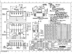

53261-0271 is a 1.25mm Pitch PicoBlade Header, Surface Mount, Right-Angle, 2 Circuits, Tin (Sn) Plating. Here is the engineering drawing for the connector.
The Molex 53261 connector series goes up to 17 circuits. Check the last line of the legend on the right. It will show you the dimension of the connector needed for your logic board. Do not rely on stock images to determine the connector
