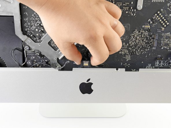

  24. Installing iMac Intel 27" EMC 2429 Dual Drive Kit (HDD or SSD): crwdns2935265:024crwdnd2935265:01crwdnd2935265:01crwdne2935265:0
    • Use the flat edge of a spudger to push the camera/Bluetooth/ambient light sensor connector out of its socket.

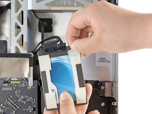

  35. Installing iMac Intel 27" EMC 2429 Dual Drive Kit (HDD or SSD): crwdns2935265:035crwdnd2935265:01crwdnd2935265:03crwdne2935265:0 Installing iMac Intel 27" EMC 2429 Dual Drive Kit (HDD or SSD): crwdns2935265:035crwdnd2935265:02crwdnd2935265:03crwdne2935265:0 Installing iMac Intel 27" EMC 2429 Dual Drive Kit (HDD or SSD): crwdns2935265:035crwdnd2935265:03crwdnd2935265:03crwdne2935265:0

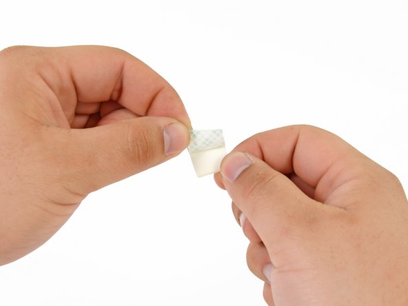

    • To secure your new drive in your iMac, you will need to place high strength double-sided tape at the four corners on the side of the drive with the SATA connectors.
    • Peel the backing off one side of the double sided tape.
    • Press the exposed adhesive side of the double sided tape to the corner of the SSD.
    • Be sure not to cover the SATA connectors with the double sided tape.
    • Repeat the above process for the remaining 3 corners.

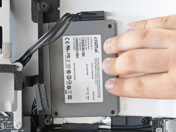

  36. Installing iMac Intel 27" EMC 2429 Dual Drive Kit (HDD or SSD): crwdns2935265:036crwdnd2935265:01crwdnd2935265:03crwdne2935265:0 Installing iMac Intel 27" EMC 2429 Dual Drive Kit (HDD or SSD): crwdns2935265:036crwdnd2935265:02crwdnd2935265:03crwdne2935265:0 Installing iMac Intel 27" EMC 2429 Dual Drive Kit (HDD or SSD): crwdns2935265:036crwdnd2935265:03crwdnd2935265:03crwdne2935265:0
    • Connect both the SATA data and SATA power connectors to their respective sockets on the SSD.
    • Peel the backing off of the double sided tape.
    • Carefully set the SSD into the iMac optical bay as close to the lower left corner as possible.
    • Do not repeatedly stick and un-stick the tape, as the adhesive will become weaker.
    • Once you are happy with the SSD's placement, firmly press down along its edges to ensure full adhesion.
    • When re-installing the optical drive, the SATA cable will be sandwiched between the foam padding and the optical drive.
To reassemble your device, follow these instructions in reverse order from Step 27.
