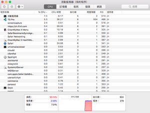

1: CPU Load OVER 90%~100% when use 5~10 mins
2: When CPU OVERLOAD is on, EVERYTHING SLOW. But if I close the MacBook up about 30 secs then open it back, CPU Load is back to Normal, but 5~10 mins passed, it will back.

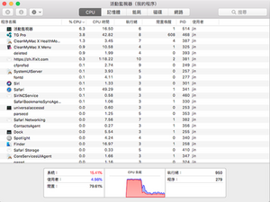

4: Keep CHARGING , CPU Load keep in Normal
Keep Charging with 85W Apple Original Power Plug everything is well , but if I remove the power charge, CPU Load will Over 90% IMMEDIATELY

Here is the test screenshot
CoCoNut 21% charging
CoCoNut 100% without charging
I just reboot about 2mins and TGPro status
lagging TGPro status
and the system background window
(CPU System Load - User - Idle)
v this is my close up 30secs reopen capture v

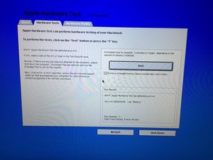

I really think you need to do some deeper diagnostics here! The very first is to run the onboard diagnostics. Boot up your system pressing the D key to get into it. Did any errors pop? If so what did you see.

@danj Hi,I just uploaded the tested screenshot,please take a look
I'm doing a Extended Testing now
So you need a new battery. Lets install CoconutBattery and get a snapshot of the main window one with the MagSafe charger connected and the other with it disconnected when the battery is around 75% full. Adding images to an existing question You don't need to do the extended testing.
@danj I pressed the Stop Testing button and it didnt stop around 15mins
Can I force shutdown(hold the power off)?
