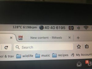

Here is a photo of my temperature readout. The 128C is what the system is saying, which is nonsense as the air from the fan exhaust is cool.
The two other temperatures are from an app called Temperature Gauge 4.1 which is set to give CPU 2 Core and CPU PECI temperature sensor readings.
Dude... Its your cpu sensor.. which is died... Sending wrong value... Now you have 2 options ... Get ur mb replaced or a cheaper one ... Delete mac kernal 's profile file ... .plist
