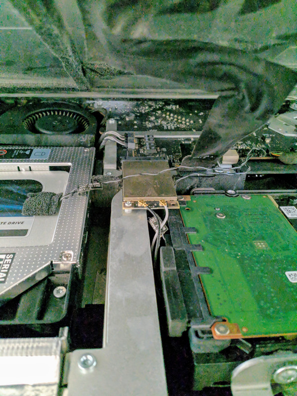

recently I installed an SSD unit in my iMac 21,5’ Mid 2010. Unfortunately, even though the SSD is correctly detected by the machine, I’m not able anymore to connect to Wi-Fi or pair Bluetooth devices.
On the Bluetooth icon I get: no Bluetooth available.
For both Wi-Fi and Ethernet, instead, I’m able to connect to networks (which means that the Airport card should be working at least) but I have no connectivity at all.
I already tried SMC and PRAM reset but nothing changed.

I’ve finally installed Mac OS on the new SSD drive. Everything is working fine except for Bluetooth.
I also managed to re-open the computer to check if the Bluetooth module was disconnected, but it appeared to be fine. Everything was in place and the plastic tape around the module was not even touched.
I really do not get why I’m not able to use Bluetooth anymore.
Image of the internals:

Clean the blob off the cables in Pic #1 This is likely a patch someone did and thats the failure.

In your first picture here on the far right wires is a blob of glue covering them clean it off as the wires are broken under neath
Is this what you're referring to?
https://i.postimg.cc/Kj421QPG/Pics-Art-0...
Yes, take the tape off so you can inspect the connections.
@bacchinif - Some of us need a few zzz’s at night.
You’ll need to check your connections on the logic board side as marked in Red here
Either you’ve put the wrong cable onto the connection or the connector is damaged (cable or board) so its not making connection.
