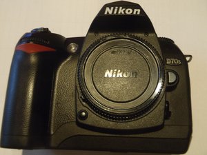

The body of the camera is getting sticky
Dear Sir
Iam noticing that body of my d70 nicon camera is getting sticky. What can Ido to solve this problem?
Hope that you find a solution.
Thanks
George Sciberras
Malta
crwdns2889612:0crwdne2889612:0 19
crwdns2944067:019crwdne2944067:0
sticky as in when you touch the camera, or sticky as in the components of the camera are getting stuck?

for the body of the camera you can use Edwal film cleaning solution or 91% Edwal film cleaning solution or my personal favorite, a 90+percent isopropyl solution (your local pharmacist would be of great help if you can't find it). Take a cloth and dip it in the solution and wring it out so that it is almost dry and wipe the body off. You can also use an old, soft toothbrush or small model brush dipped in the solution. Isopropyl alcohol works great to clean off cameras; any excess moisture that gets in the camera will evaporate quickly, and the alcohol works well to remove grime, grease, oil, etc. Hope this helps, good luck and may your camera soon sparkle again.

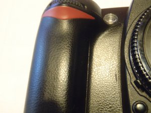

Natrual soft rubber will deagrade and return to its "Non-Vulcanised state". It is actually slowly "un vulcanising". Molecule cross links breaking back apart that were joined in the rubber vulcanising process, and becoming liquid in state. Handling or sitting, you can not stop natural soft rubber from "going back home".
The top surface is effected 1st which then deepens and deepens until you could wipe the entire rubber off with cloth after 25 years. More rigid high vulcaising rubber will powderise back to dust. (like 50 year old tyres)
Using alchohol will merely disolve and strip the top liquid rubber layer off, back to the "still rigid" rubber underlayer. You'll need to do it again in a few years.

Following the advices here, I rubbed my old F80 and D70 bodies with pure Isopropyl alcohol (99.8%) and a lint free cloth, and both recovered the original grip and look. It's a job that one has to do with plenty of time and detail to get a perfect finish, but it's worth the effort. I have a AF-S DX 18-70mm zoom that needs the same treatment on the focus grip. Just be careful to do it in a well vented room (Isopropyl alcohol is harmful if breathed). Thanks a lot for your help!

I have a Nikon D70s with a very sticky body. I rubbed 91% Isopropyl Alcohol on the entire body about 6 times which finally eliminated the stickiness but it dulled the finish. I then used several ArmorAll clean wipes to coat the finish and restore the sheen. I may have to do it every few years but it's well worth the effort.
I pulled the camera out today and found that there are no sticky parts on the body 3 1/2 years later. Bottom line, Isoproply Alcohol and ArmorAll wipes really works.
Six years later and there is still no stickiness on the body. It appears the Isoproply Alcohol and ArmorAll wipes permanently solved the problem.
Again I pulled the camera out for a day of shooting and still no stickiness. Using Isopropyl Alcohol really does permanently solve the problem. BTW, early model Nikon DSLRs like the D70, D70s, D80, D90 and D40x are super cheap today and are still fun to shoot with.
Alcohol removed the rubber coating on the plastic body. You now have a plastic finished D 70
@om1gc - The camera body looks and feels exactly as it did when it was new. No plastic showing through.
Same problem with D70. The secret with the isopropyl is a gentle wipe. Don't try to rub it dry as I did the first time. Allow each cleaning session to become well and truly dry so that the 'plastic/rubber' becomes firm again. As with Ken above, patience is required . 4 or 5 'sessions' and it's fine now.

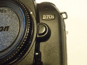

>90% alcohol will remove the sticky rubber - if rubbed away with a lint-free cloth. Do this for a thin layer once a day and let the alcohol evaporate before repeating. If after 5 goes at this it is still sticky, then move to step 2 below:
STEP 2
Nikon F70s had only a thin rubber layer on top of a polycarbonate camera body. If the rubber has deteriorated to full thickness then it will come off the plastic as a sticky, tarry mess. that will never improve however many layers you polish away. The only solution then is to either
[1] rub talcum powder into it to reduce the stickiness as a temporary fix - but it always returns worse than before with a black “porridge” on your fingers!
[2] carry on a rub it all off (with ear buds, tooth brushes etc to get the remaining rubber off around buttons etc, This leaves a shiny plastic camera that is slippy to the hands. Consider adding a strip of tape, or leather or rubber to the hand grip area to restore finger friction and prevent drops.
Best of luck to you all - PaulC

Hi Ken - Nikon F70s had very thin rubber layers of <0.5mm coated like paint onto a poycarbonate body panel while digital Nikons (like the D70) had very thick rubber skins of several mm thickness over a metal chassis.
My D50, 80 & 200's all have very thick rubber which fix obligingly with isopropyl alcohol.
The most common causes of rubber deterioration are exposure to light, oxygen (ozone) and heat - and sometimes to chemicals in cleaning materials we use (or "misuse"!) on our camera bodies. This explains why cameras used and stored in different conditions decay at different rates.

For those who clean their Nikon cameras, The D70 can look shiny if all the rubber is removed. Grip side has more decay and now is down to the base plastic.
The left side has less decay and some rubber material remains
Both sides are now not sticky. The grip is still OK to use but you may want a strap There is no removable rubber cover to replace, once decayed it will rub off.
