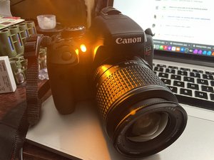

Yellow light flashing on front of camera and will not let me take a picture. Pop-up flash kept hitting hat brim and eventually stopped working. This is for my EOS Rebel T5 1200D
I have removed the battery and that did not solve the problem.

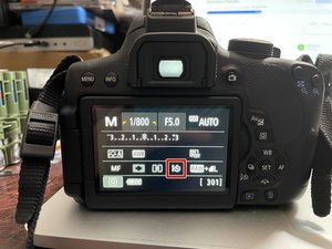

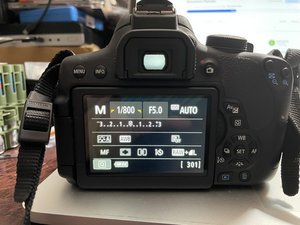

I know that you probably aen’’t having this problem anymore but I also had it and figured out that I had accidentally turned on the timer on my Rebel t6. The yellow light should blink for about ten seconds before taking a picture. To turn this off (on the t6) click on the left button next to the set button and then select “single shooting”. I hope that helps!

Posted photos on my answer to confirm this, checked on a T6i.
Essentially the T6i is the full fat version of your T6.

It's the self timer mode.
