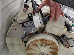

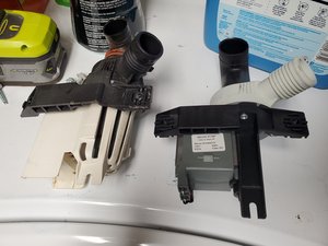

I finally found the leak:
The pump was leaking out of the spade connectors. I bought a cheap internet replacement pump, installed it, and no more leak.
