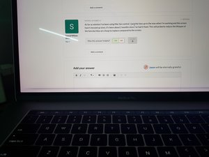

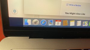

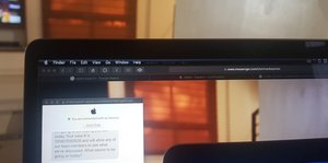

Horizontal lines on top and bottom screen

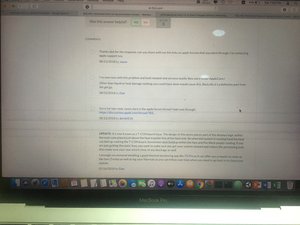

Hi i have huge horizontal semi transparent lines on top and bottom of my 2016 touchbar retina macbook pro 13inch.
Other symptoms includes No audio devices found(cant play sound)
Is there any possible reasons for this? I highly doubt is a software problem.

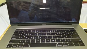

Looks like you also have the same problem as black bar at the bottom screen!
Sadly your screen is failing! You’ll need to see if Apple will cover it under an extended warranty exception!
Update (08/23/2018)

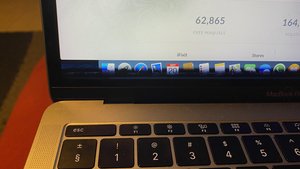

Apple has had quite a few of these now, All of the Touch Bar 15” & Fn 13" have this affliction. The 13” Touch Bar appears to be less effected! The T-CON board which sits between the heat exchangers within the main body can over heat damaging it. Either the fans have failed or the vents have be blocked so the system is staved of fresh cool air or the exhaust vents in the back are blocked by bedding. I've also seen dust build up as an issue.
If your warranty has expired you'll need a new display assembly as the T-CON board is part of the assembly.
If Apple has stuck with the older display design with the T-CON logic within the lid this wouldn't have been such an issue as the display area is much cooler.

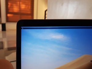

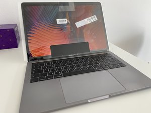

Hello, I have the same problems. Macbook Pro 2017 - I have a 13-inch model. At first, horizontal lines appeared at the top, and now the screen is completely filled with lines. I use the screen by connecting it with HDMI. I think this is Apple's chronic problem. We need to organize a campaign for Apple to make free exchanges.
crwdns2889612:0crwdne2889612:0 10
My problem was solve, Apple in LatinAmerica change the entire screen for free
BTW, the problem appears to be related to a heat dissipation issue, since then I have been always using Macs fan control, it is for free, my MacBook is always cool (no more than 50C any sensor), hopefully I will no have the same issue

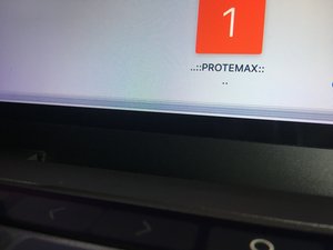

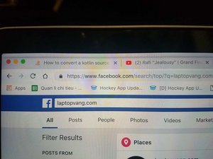

When you see the discreet scan lines these are caused by the T-CON board failing from the heat from the heat sink fins boiling up cooking it.
In some cases cleaning the fans and fins of dust build up (as well as the rest of the system) for better cooling as well as not blocking the exhaust area in the back.
Sadly if cleaning doesn’t solve things you’ll need to replace the display assembly.

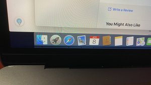

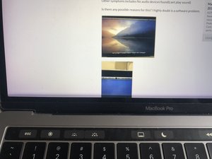

UPDATE: It's now known as a T-CON board issue. The design of this series places part of the displays logic within the main case placed just above the heat transfer fins of the heat sink. So when the system is running hard the heat can boil up cooking the T-CON board. Sometimes dust buildup within the fans and fins block proper cooling. If you are just getting the static lines you want to make sure you get your system cleaned and reduce the processing load. Also make sure your rear area is clear of any blockage as well.
I strongly recommend installing a good thermal monitoring app like TG Pro as it can offer you a means to ramp up the fans (Turbo) as well as log your thermals so you can follow over time when you need to go back in to clean your system.

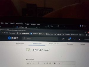

Recorded my display misbehaving today:
https://www.youtube.com/watch?v=p6FficHt...
At least in my case, these lines only appear after a while (~30 min or more). If I shutdown the computer and turn it back on right after, lines will still be there. However, if I wait a couple minutes before turning it back on, they won’t be there. The angle of the display doesn’t matter at all. Leaving the macbook on for long periods of time does make the problem worse. In this case, lines get darker and sometimes appear at the bottom as well. Ventilation seems to be working just fine and I can hear the fans kicking in during intensive tasks. Today when the lines appeared I placed my macbook in front of an AC unit and the lines faded slowly, so the problem is most likely heat related.

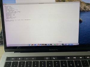

I have the same issue and I have narrowed it down to the dGPU. Every time the dGPU is active (external monitor, any app that uses dGPU), these lines appear.
If I remove the event causing dGPU use (disconnect monitor, exit apps using dGPU), the lines disappear quite quickly. I can reliably replicate this and monitor GPU usage in iStat menu.
Strangely, the external monitor itself doesn't show these lines, which is weird. I would have that a failing GPU would output glitches to all displays its driving.

My Macbook Pro 13-inch 2017 touchbar model also started showing this issue around two months ago. I did not take it to repair service (and now, with COVID-19 pandemic, it will probably take longer to do so), and I've been closely monitoring it to understand what might be happening.
I wanted to share what I learned:
  1. As others are saying, when the computer is left resting (lid closed) for enough time, the lines disappear.
  2. The lines might appear after some time using it, but this will depend on what type of task you are doing. Simple tasks usually do not trigger the heat issue and I can use the computer for hours without seeing them. What I observed is that any task that requires VIDEO PROCESSING (and here I'll guess that means GPU use) will make the problem pop up very fast. Watching any videos, for instance, will trigger the problem after a while.
  3. Once the problem starts, it will get worse and worse until you close the lid and leave it to cool down. Until now, the problem completely disappeared after cooling down. It did not leave any permanent damage to my screen, no matter how bad it looked before.
  4. I bought a notebook cooler to see if this would prevent the problem. It didn't.
  5. I also installed Macs Fan Control and tried using the notebook with 100% fans speed and with the notebook cooler. It did not prevent the problem to appear either.
  6. The problem did get worse since the first time I noticed it. Now, I see more lines are affected (maybe two times more from the beginning). But it looks like it stabilized in the last month (of course I have started closing the lid as soon as I can when it gets bad).
  7. On cold days (< 20ºC) the problem seems to be harder to show up. On hot days (> 30ºC), even normal usage might trigger it. If you have air conditioning, this might help you keep working.

Hi there! I have a mac book pro 13 inch from 2016 with the same problem. Horizontal lines that ends up in a completely glitched screen. Apple told me i'll have to pay 850 dollars for a new screen, they're nuts. I went through the support online and they told me it's not possible to make an exception and change it for free as i'm out of warranty. Had to wait 2 days for this sh** response. Guess i'll keep complaining until someone hears me. Really don't know if buying a macbook again
My MP 2017 is fixed by (unofficial) local store, they spend a lot of time to investigate, and they find out the root cause, I remember they said they just replaced a wire somewhere connect to monitor (hmm, I can’t remember exactly, but the point is “a wire cause this issue”). So I don’t have to replace any hardware else.
This is my screen before repair (horizontal line at the top edge and bottom edge):
crwdns2944067:011crwdne2944067:0:
Is it the same issue as the flexgate? Did they change the flex cable of the LCD?
Even though what we have is a different issue where we have black lines across the screen instead of the backlight being disabled in Flexgate.

I’m another victim of this problem. My device is MacBook Pro 13-inch, 2017 with Touch Bar. it seems that it’s heavily affecting 2016 & 2017 models, 2018 will follow soon.
I’m running my Mac always in A/C controlled environment, few lines start to appear at the lower part of display then increase in numbers until they form a thick grey bar. the only way to solve it is to close the lid or shutdown the laptop for an hour or so.
Sometimes this thick bar starts flickering and displaying random rainbow colors as show.

I’m Having this issue with my Macbook Late 2017 (A1708)
Update
I have tried every possible thing nothing worked, I literally had to give my mac away to some guy who later used it for spares, all I got was 50$… Apple will never claim responsibility its been 3 years since the product came out and I dont thing if they havent agreed until now they will.
I have attached a picture of my mac
Nishant - Your T-CON board has failed! You'll need a new display assembly to get this fixed

Late 2016 13' TouchBar got same issue here!! And 6 months out of warranty, anyone with the solution?
Same here.
You can see the mouse cursor rolling on the screen
this happens after somes hours using. If i shutdown and wait for an hour, it disappears.
Anyone know if i have to change the whole display or there some kind of fix.
Thnks
Thats exactly what happens to mine too. The lines appears some minutes after boot. It tends to get worst, now I have many more lines and they appears much faster.

Hello,
I am also one of the countless victims of this problem.
No luck, I don't have an apple store in my country and because of the lockdown, I can't send it to another country.
So I went to a professional apple repairer and I changed then screen with a new one.. but the problem returned again a few days later.
I went back to the repairer again who was surprised, we thought at the beginning that the problem came from the new screen (manufacturing defect), he then changed the screen again with another new one ...
But again, a week later, the horizontal lines reappeared below the screen especially when I plug it in with an external monitor.
This is where I discovered this topic and I get to better understand the problem.
But my question is: Why does changing the screen not solve the problem? knowing that those who have changed the screen at Apple no longer have problems? Also, are the 2 new screens are actually really damaged for good ?

A test you can do to see your device is defected with this issue.
Use your MBP for a time then put a solid grey background on your screen and check if you can see a dark lines on your screen
