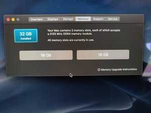

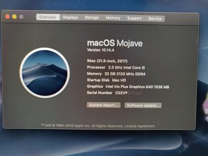

Just completed the 32 gb RAM upgrade thank you for the digital assist. Your tool kit was priceless and the tips on getting the display off where critical. No real issues after that. It was fun taking apart the entire system and getting an inside. look at it. I did lose a screw that holds the hard drive mount in place so that slowed me down a bit. It had lodged itself under the mother board... so it took me a while to back track and find it. The tricky bits where: 1) replacing the hard drive SATA cable 2) replacing the power board cable. 3) replacing the lower support bracket (chin strap).
Success!!! Followed guide on iFixit, system booted and allowed clean install of Mojave on SSD, installed while open.
