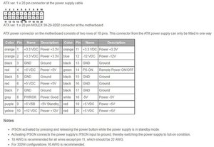

You may consider replacing it with an ATX etc. power supply. Here is the pinout for your power supply
and here is the pinout for an ATX power supply
from here So as you can see it should be possible of using one of those. You will have to use your wiring harness sine you need the connector to the logic board.

You'll be okay without the "other" power plug on the PSU. I do agree that if you want to go and restore your G3, restore the power supply as well.
