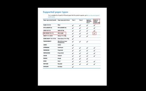

Here is an image taken from the User Guide for your printers.
(click on image to enlarge for better viewing)
Here's a link to a page that shows the conversion from US to International Paper weights.
To me it looks as though your printers do not support the 120lb (approx. 325g) cardstock media, when using duplex mode. Perhaps that is why they are jamming
From the chart in the User manual it appears that the heaviest paper weight (or thickness) that the printer officially supports is 175g (or 65lb) and that is not in duplex mode. In duplex mode it is only 30lb (or 110g)
