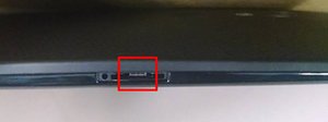

Location of the Water damage indicator
Hi
I went for a run on Sunday and got caught in a rain pour. Couldn't put my phone away immediately and it got pretty wet.
Now part of the touch screen doesn't work, horizontally, finger wide area at the height of the power button.
Anyone know where the water damage indicators are on this phone? I found the battery one.
Thanks!
Hey Lorenz,
For Motorola its only at battery and slots like the simcard or the Microslot
Take out the SIM tray, and a white square sticker should appear near the entrance of the SIM tray. You may need a flashlight to see it better. If the sticker is pink or dissolved, then it does have water damage.
Hope that helps.
