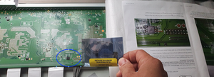

I had this issue and came across this blog that helped fix it with a multimeter and an hour of my time. https://integer13.wordpress.com/2018/04/...
Hope this will help others too.
This is called the 'jump start' method and I don't recommend to use this method. It sometimes works, but it can also destroy one of the video processors. This is explained in more detail in this video from Coppell TV Repair:
https://www.youtube.com/watch?v=o6jL2a_L...
Here is the link with comments: https://integer13.wordpress.com/2018/04/...

So, it’s the IC205 on the mainboard – quite easily found (once you can get to the mainboard – I’ve a spare one, of course). This chip is an MX25L8006EM2I-12G.
I buy a CH341A SPI Programmer with SOP8 clip.
Can I then follow this guide?
https://www.win-raid.com/t4287f16-GUIDE-...
I plug the programmer into a USB port and correctly connect the clip (connected to the programmer) to the EEPROM IC205 and issue on my Linux computer command line:
$ sudo flashrom --programmer ch341a_spi -r backup.bin
If I get no errors, I then issue the command:
$ sudo flashrom --programmer ch341a_spi -w lg31mu97.bin
having downloaded lg31mu97.bin from the link given in the WordPress blog:
http://aleksikoski.com/temp/lg31mu97.bin

– Open the monitor removing the back (good instructions here: https://www.youtube.com/watch?v=lpWgPESO... )
[EDIT]⏎
A small note here:⏎
1. My AV software called this potentially unwanted software and grabbed it. I used this software with my AV software running (after whitelisting it and nothing malicious occurred). ⏎
2. Use the chip detect to try and sniff out what chip you have, this is the best approach so you don't have to try and guess at the settings.⏎
3. Install the drivers first, before plugging anything in.⏎
4. The chip in both of my monitors is a MX25L8006E, your mileage may vary here. I used the 25 SPI BIOS section of the programmer with its default settings.⏎
[/EDIT]
– Using the CH341A programming software and instructions in the video above, first erase the software (don’t forget to erase first or you will get an error message) and then write using the monitor software for the EEPROM chip: http://aleksikoski.com/temp/lg31mu97.bin
– Unplug everything and check if you can turn on the monitor.
– If you can turn on the monitor, reassembly it carefully
Some thoughts:
– The lg31mu97.bin downloaded from the link above seemed to have a problem with the EDID and my computer would just recognize it as a ‘Generic PnP Monitor’. So, since now the monitor would turn on I had to go to the ‘service menu’ and perform 2 steps: WRITE EDID (change it to Yes) and NVRAM INT (change it to yes). This will ‘rewrite’ the EEPROM from an internal copy. Turn the monitor off and on, reboot your computer and it should now show LG 31MU97 in the “Windows Device Manager Monitors” list and work properly with your graphics card. (Note: you can find instructions on how to access the service menu here: https://forums.blurbusters.com/viewtopic... . Important: disconnect the DP cable or any graphics cable to access the service menu, I had to try several times to be able to access the service menu)
– When performing the steps above, I realized, that maybe I should have just plugged the programmer and try to turn on the monitor without erasing or writing anything. I wonder if the small voltage applied by the CH341A programmer would resuscitate the EEPROM and then I could use the monitor own ‘service menu’ to rewrite the EEPROM. Someone posting in this thread in the future can confirm if this works: just plugging the programmer to ‘wake’ the EEPROM (most likely not, but I will try that next time if the problem reoccurs).
Cost of repair: $10
