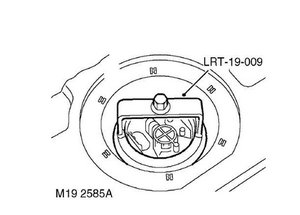

How to replace fuel pressure regulator
No instructions or schematics for 2004 4.6 SE online. They sell the regulator, then say it's in the tank?
@marshada "All the injectors are fed from a common fuel rail as part of the returnless fuel system. Fuel pressure is maintained at a constant 3.5 bar (52 lbf.in2) by a regulator that is integral with the fuel pump.
It's in the tank.
Pump - fuel
NOTE: The fuel pump and fuel gauge tank unit are integral parts of the fuel pump housing and cannot be renewed separately

11. Clean fuel pump hose connections.
12. Position absorbent cloth to absorb fuel spillage.
13. Disconnect multiplug and fuel hose from fuel pump housing.
CAUTION: Always fit plugs to open connections to prevent contamination.
14. NAS models: Disconnect pressure sensor pipe from fuel pump housing.
15. Use LRT-19-009 to remove locking ring from fuel pump housing.
16. Remove fuel pump and discard sealing ring.

1. Clean fuel pump housing and mating face on fuel tank.
2. Fit new seal to mating face on fuel tank.
3. Fit fuel pump assembly to fuel tank and use LRT-19-009 to fit locking ring.
