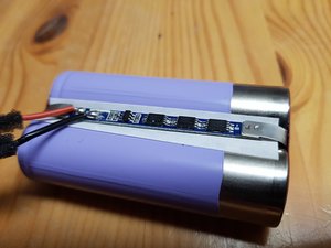

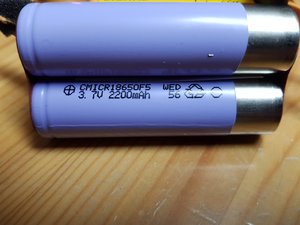

My device was not charging, got a new device from Anker 3 days later. I disassembled the broken device. There are 2x16850 batteries in parallel (1S2P config) and a small protection PCB between them with blue shrink tube all around the pack. I replaced the protection PCB with a new one (8205a type, 5A) and it worked again. Unfortunately, could not fit it back into the small case again, so built a new one from nylon slats and gaffer tape^^
Hi Steve, the speaker worked after this procedure? Where can I find this " PCB 8205a 5A" ? Thanks!!!
Do you still have a link for this pcb?
Are you Sure we are talking about the same speaker?
Opened mine up and there are two flat battery cells in series, both with a capacity of 4000mah.
Cant find a replacement Part anywhere tho...
I am 100% sure that it is the same speaker. Maybe they improved it a bit and now use LiPo batteries. But those in the picture have been taken out ouf the brand new, not working, speaker.
Hello all! Yes, the speaker worked after i replaced the PCB.
If you have access to Amazon, just type pcb 18650 (18650 is the battery type) and look for one that supports 3.7V and 5A. I found a 4-pack for 10 Euro just now.
