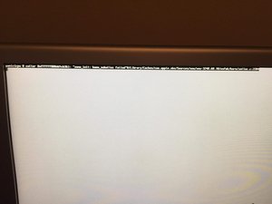

So, I was thinking of upgrading my early 2009 Mac Pro 4,1 Nehalem dual Quad-Core 2.26GHz to a Westmere 12-core but before getting my hands on such CPUs I thought I’d try out a couple of x5570 2.93GHz quad-cores (lidded, fitted with washers and 5mm thermal strips, I happened to have laying around.
The machine is firmware upgraded to 5,1.
I had to re-set cpu b about a million times before the computer would boot without any blinking power button or red lights on the backplane.
It boots fine with any of the two single processors on its own (with red light and fan at full throttle) but when both are installed I get kernel panic on startup.
I’ve reset SMC, started up with opt+R+P and nothing helps. It won’t boot in recovery mode either.
I’ve also removed the Northbridge heatsink and cleaned up the dried thermal paste and reapplied with new.
See linked picture of panic screen here: Kernel panic
(I don’t understand aaanything of it)
Any ideas?

Did you solve the problem? I've got the same trouble
Hi,
I gave up for a while, then I refitted the cpu’s 20 more times and then the kernel panics stopped. However one of the heatsink fans isn’t working and I can’t figure out why, maybe the board, maybe the heatsink fan itself. Good luck!

1) the black connectors of the heatsinkers ,
have to be reseated (a little bit out of their original position).
to be perfectly connected.
2) doing this tricky operation… NEVER OVERTIGHTEN the springscrews when seating back the sinkers.
cross pattern. never press on the top of the sinker.
count the number of rotations before (when removing the sinkers),
note them, and reproduce them with care
3) have to respect the difference of thickness of a delidded cpu and a lidded one. (3mm or 5mm),
this layer…. with 3 or 3 washers?
5mm thickness of thermal strip ? he removed the original pink layer.
