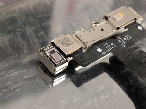

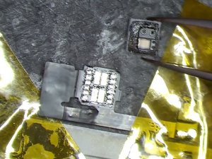

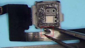

I personally do Face ID repairs when phone technicians accidentally damage the flex cables. You can desolder the Face ID Filter on the proximity sensor and move it to a brand new proximity sensor and your Face ID issue will be resolved (assuming proximity sensor is what’s causing your issue which in about 99% of cases it is). Any other questions feel free to ask or anything want to debate/correct me on.
can you post picture of what part on prox. flex cable you are referring to? FaceID Filter?
Unfortunately iFixit isn’t allowing me at this time to include any pictures. But basically what it looks like is it is a little black square at the top of the proximity sensor. If at some point I’m able to upload pictures, I’ll take some at my phone repair shop and put them on here. @petarmaras

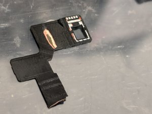

When the flood illuminator module flat cable get damage, Face ID wont work. You can fix that by replace the flood illuminator module flat cable but the original sensor has to move to new flat cable.

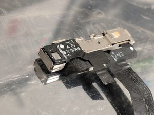

  • There are 8 components packed into the front of the phone. Infrared Camera; Flood Illuminator; Proximity Sensor; Ambient Light Sensor; Speaker; Microphone; Front Camera; Dot Projector;
  • The infrared camera, the dot projector and the front camera are located on the back glass assembly. The flood illuminator, the proximity sensor, the ambient light sensor, the speaker and the microphone are located on the display assembly. Please be careful when disassembling or repairing the phone. Damage of any of these components might cause Face ID failure.
  • The three parts ( infrared camera, flood illuminator and dot projector) are paired to the phone. To keep Face ID working, the three parts should always be the genuine parts.
  • Please be noted that there is a slot on the display assembly. When assembling the phone, the fold of the speaker flex cable should be placed correspondingly in the slot to prevent the cable from getting broken. Which will also result in the failure of Face ID.

I accidentally ripped a flex on the front camera module. I managed to get the flex unsoldered from the sensor. I plan to order a new front camera module and transfer the flex from it. I don't know if it's been done or attempted, but wish me luck.
With that interface on its flex, i wish you Best of luck....

As mentioned before, you need to transfer the proxy sensor to a new flex cable. There is anither component on the front facing camera, and the idea is the same. You need to transfer it to the new front camera.
This is onyl acheivable via mirco soldering
