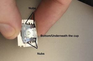

as my photo shows, the numbs of the cup are fixed on the board, so you can't fixt he cup without a drop of a glue, I guess
Any idea what kind of adhesive was used? As einstein mentioned, it doesn't look like the switch will stay put without it (at least on the left shift key that I'm replacing)

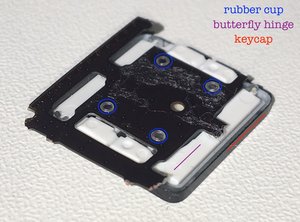

this shows how the whole key is fixed. it may help

So... by accident the rubber dome came off. And it just looks like it is just held in place by some sticky residue. A very thin layer of it. I wouldn't just put glue on the board since you have to apply a thin layer only on the dome and none on the switch and contact points.

When you glue it back on, make sure to cover all the surface of the cup not just nub parts.
If you only glue the nub part you'll have unreliable key register as well as wobbly key cap.
and mine is already f-ed up so good luck with whoever has the same issue.. :)
also super glue works fine. Just be careful with it.
I’m having the same issue. I’m attempting to reinstall it, but do the nubs fit inside the actual holes inside the key space or do they sit on top?
Kinda both, but more on top. They fit well enough to keep the key aligned but it won't fit deep enough to be secured, even if you try to force it.
When you put it back on (rubber cup and plastic clip) make sure to test it.
Press each side of the clip and see if it reacts same way. (pressing either side should make opposite side go down as well.)
If not, gently remove the cup before the glue dries and try again.
