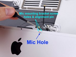

The problem is that after reassembly, the microphone input is faint and muffled. It functions, but barely, and is essentially unusable. The culprit turns out to be the adhesive strips used for reassembly. The frame of this iMac model seems identical to its 2012-2015 predecessors, so ostensibly the same strips made for these earlier models would work here too. However, the microphone has been moved from the top of the computer (near the webcam) to behind the frame at the bottom of the screen.
Note the location of the "4R" strip in the following picture:
https://d3nevzfk7ii3be.cloudfront.net/ig...
Now look at the location of where the microphone has been moved to:
One can clearly see that the "4R" strip completely covers the microphone and the holes in front of it, deadening any sound picked up.
Knowing this, the solution is simple. Make sure the microphone works properly before using any adhesive. Then, apply the adhesive strips, but when laying down the "4R" strip, cut away the portion covering the microphone (and a little bit more from each side to be safe).

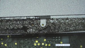

for future fixers, here’s some verification of the above info. The first photo is how I found the adhesive as soon as I peeled it off, clearly a clean cutout of the adhesive from the factory for the microphone. And then the second photo after I uncovered the other two holes.

Eve Ann Wallis - This series has a unique issue! Apple moved the microphone hole! And in doing so have messed up a few people. You need to modify the bottom tape with a small cut out so the hole is not covered. Here’s the location of the microphone hole:
At this point you should get another adhesive tape kit and after fully cleaning the old tapes off, modify the new set as needed but cutting a small area at the bottom edge of the strip where the mic is and give that a go!

Confirmed. Re-did the adhesive cutting the whole for the mic. I got the opposite piece (4L) too because I wasn’t sure if that was also a mic hole. Sounds is great now.

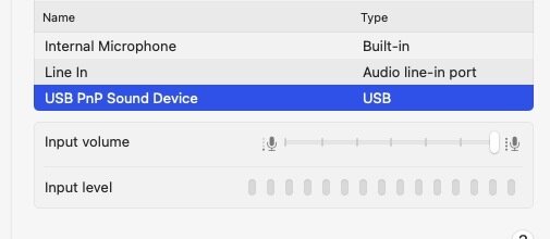

Hello :) I found myself in this situation as well :) I had even tested the mic before taping everything up - but there I went and covered the mic with tape as well when putting everything back together :( . Just incase .... wished to share that I found an incredibly small ( no bigger than 2 cm) usb mic from amazon for 7$. When you turn up the "gain" in system preferences it sounds exactly ( 90%) like the original iMac mic if you wish not to re-open the iMac ... Thank you all again for sharing this find and story !
