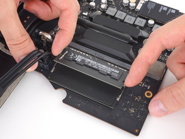

  63. iMac Intel 21.5" Retina 4K Display (2017) Logic Board Replacement, RAM: crwdns2935265:063crwdnd2935265:01crwdnd2935265:02crwdne2935265:0 iMac Intel 21.5" Retina 4K Display (2017) Logic Board Replacement, RAM: crwdns2935265:063crwdnd2935265:02crwdnd2935265:02crwdne2935265:0
    • Two clips secure the RAM module in place, one on each side. Using your fingers, spread the clips away from the RAM module.
    • When released, the RAM module will pop up at a slight angle.
  64. iMac Intel 21.5" Retina 4K Display (2017) Logic Board Replacement: crwdns2935265:064crwdnd2935265:01crwdnd2935265:02crwdne2935265:0 iMac Intel 21.5" Retina 4K Display (2017) Logic Board Replacement: crwdns2935265:064crwdnd2935265:02crwdnd2935265:02crwdne2935265:0
    • Lift the RAM module to an angle of about 30 degrees and slide it out.
    • When handling the RAM module, touch only the outside edges. Take care not to touch the gold-colored contact points along the bottom edge.
    • To install a new RAM module, slide it in place at about the same angle until it is snug, and then swing it downward until the two clips snap into place.
