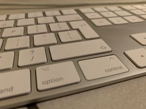

Thanks, I didn’t know about the sliding clips. When trying to put my keys back, I pushed them down instead of sliding them making the clips bend inwards. This made my key sit flush with the casing:
When I read your post, I took them back out and unbend the clips with a knife so that I could slide them into place. Now they’re more or less OK. So thanks!
