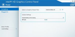

Finally found a solution that worked for me, it’s in the Power Options: Control Panel > Power Options > Change plan settings > Change advanced power settings > scroll down to ATI Graphics Power Settings > ATI Powerplay settings. Here, under On Battery, mine was set to Maximise Performance. Change this to Maximise Battery Life > Apply. Flickering stopped and I can adjust brightness no problems.
You can check Lcd with VGA port and when i check i understand that battery is good .
I solved this problem by replacing the screen
This solved my flickering problem of my asus X556UB when unplugged. INTEL GRAPHICS set on MAXIMUM BATTERY LIFE
I had this same issue with an Asus I was working on. It drove me nuts until I went into power settings and changed the TDP level on battery from 15W @ 2.2ghz down dow to 11W @ 0.6ghz. Stopped immediately.

Go to power plans in control panel and create a power plan with all the settings to medium. i mean graphics, cpu power management all of that. Restart pc and see
