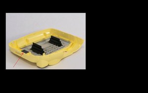

Hi, I'm really hoping someone can help. I followed a break down tutorial to fix a camera I'd been given as faulty but there's one part which dropped out when I first opened it and I'm not entirely sure where it should go. I can't seem to find any guides which show you how to put them back together.
The piece is a small with a groove and a hole set off to one side.
Hopefully you can see the piece in the image attached.
I would really appreciate any advice.

I finally managed to find out where this piece is from, it slides in behind where the strap holes are on the casing!

Hi @nictakespics ,
I'm with you on this one. I can't make out where it belongs either.
The only thing that might look like it and I won't be surprised if this is totally wrong is if it belongs in the film compartment cover. Here is an image of where I mean. It is not a good view of it but it should be one place where there is a hole of about the same size. The image is taken from Step 2 of the Camera Shell Replacement guide.
(click on image to enlarge for better viewing).
Just tell me if it is wrong and I'll remove it from this answer so as to not confuse other people in the future.

Hi @jayeff
I'm sorry for the late reply. I've just looked at the area you've pointed out but unfortunately it doesn't appear to be from there. I'm completely confused by where it could've come from. I've studied all the images I can find and can't see anything that looks like this piece. I've noticed it in videos but none of them explain what it is.
