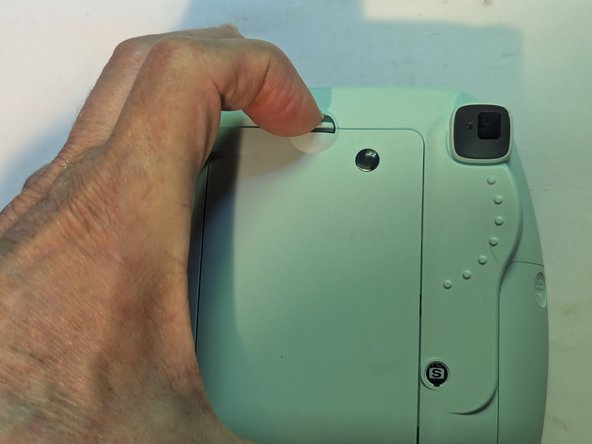

  3. Fujifilm Instax Mini 9 Camera Shell Replacement, Remove the Batteries: crwdns2935265:03crwdnd2935265:01crwdnd2935265:03crwdne2935265:0 Fujifilm Instax Mini 9 Camera Shell Replacement, Remove the Batteries: crwdns2935265:03crwdnd2935265:02crwdnd2935265:03crwdne2935265:0 Fujifilm Instax Mini 9 Camera Shell Replacement, Remove the Batteries: crwdns2935265:03crwdnd2935265:03crwdnd2935265:03crwdne2935265:0

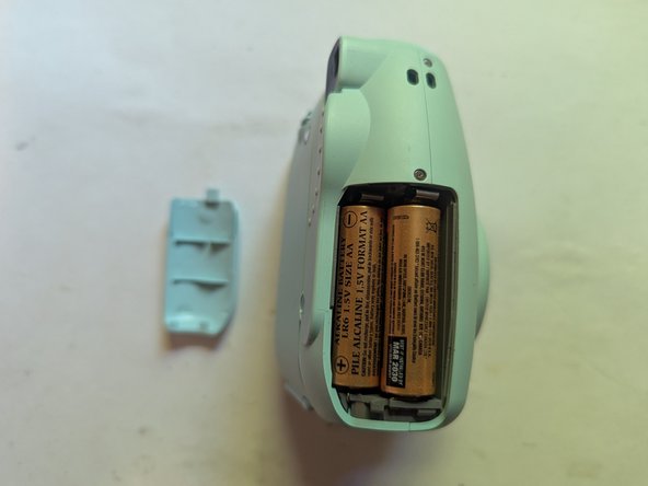

    • Push up the battery lid lock.
    • Slide off the battery cover.
  4. Fujifilm Instax Mini 9 Camera Shell Replacement: crwdns2935265:04crwdnd2935265:01crwdnd2935265:01crwdne2935265:0
    • Remove the batteries.

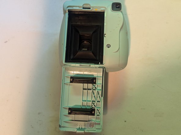

    • Press down the back cover lock to open the back cover.
    • Grasp the rectangular holes in the film pack, then pull it straight out.

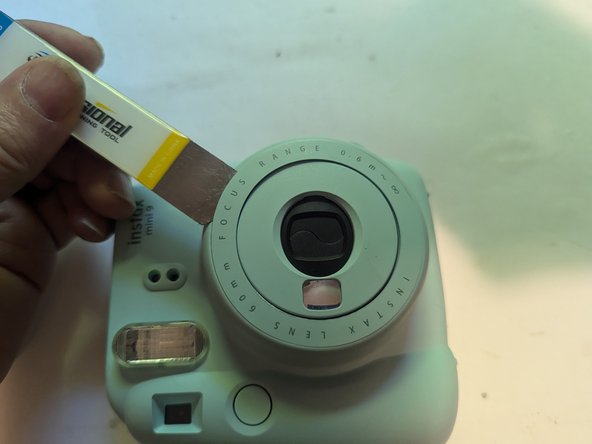

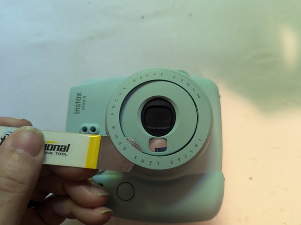

  7. Fujifilm Instax Mini 9 Camera Shell Replacement, Remove the Brightness Adjustment Dial Cover: crwdns2935265:07crwdnd2935265:01crwdnd2935265:03crwdne2935265:0 Fujifilm Instax Mini 9 Camera Shell Replacement, Remove the Brightness Adjustment Dial Cover: crwdns2935265:07crwdnd2935265:02crwdnd2935265:03crwdne2935265:0 Fujifilm Instax Mini 9 Camera Shell Replacement, Remove the Brightness Adjustment Dial Cover: crwdns2935265:07crwdnd2935265:03crwdnd2935265:03crwdne2935265:0
    • The brightness adjustment dial cover is held on with double sided adhesive and three tabs. Insert a thin blade opening tool under the outside edge of the cover.
    • Work your way around the ring, separating the adhesive.

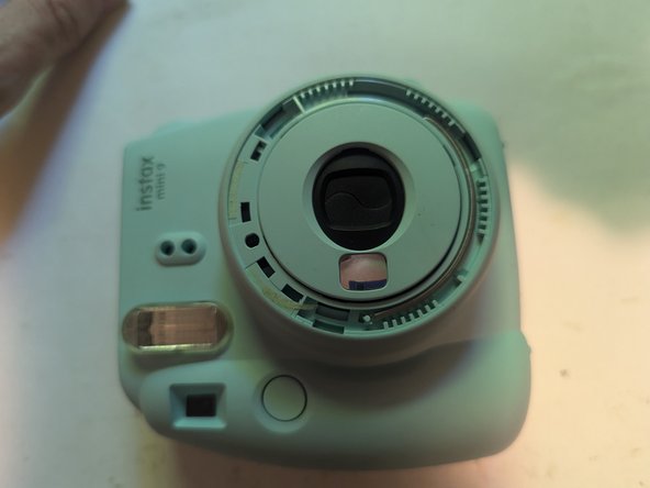

  8. Fujifilm Instax Mini 9 Camera Shell Replacement: crwdns2935265:08crwdnd2935265:01crwdnd2935265:02crwdne2935265:0 Fujifilm Instax Mini 9 Camera Shell Replacement: crwdns2935265:08crwdnd2935265:02crwdnd2935265:02crwdne2935265:0
    • Lift the cover off.

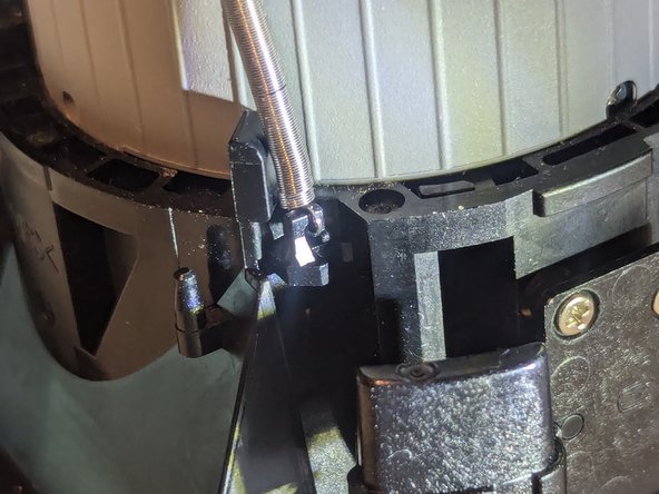

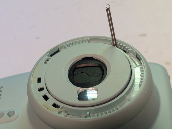

    • Here we can see the return spring that pulls the brightness adjustment dial back to its resting position. This will have to be disconnected to remove the front cover.

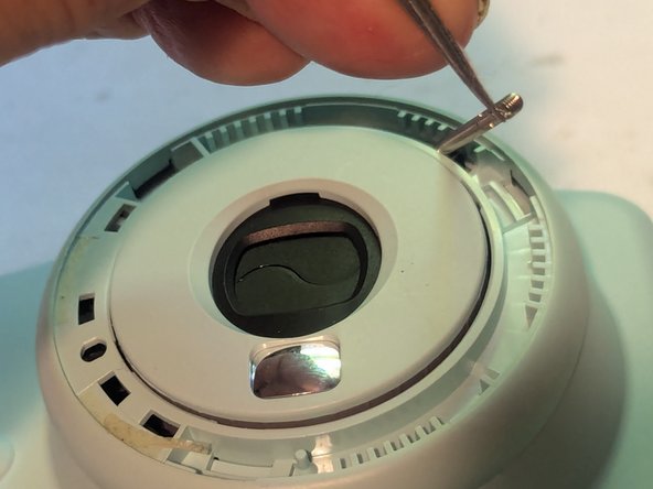

  9. Fujifilm Instax Mini 9 Camera Shell Replacement, Disconnect the Brightness Adjustment Dial Return Spring: crwdns2935265:09crwdnd2935265:01crwdnd2935265:03crwdne2935265:0 Fujifilm Instax Mini 9 Camera Shell Replacement, Disconnect the Brightness Adjustment Dial Return Spring: crwdns2935265:09crwdnd2935265:02crwdnd2935265:03crwdne2935265:0 Fujifilm Instax Mini 9 Camera Shell Replacement, Disconnect the Brightness Adjustment Dial Return Spring: crwdns2935265:09crwdnd2935265:03crwdnd2935265:03crwdne2935265:0
    • Using fine tip tweezers, grasp the end of the spring and lift it straight up off the retaining pin.
    • You can leave it like this as it is still connected to the camera itself on the other end.

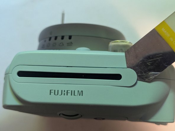

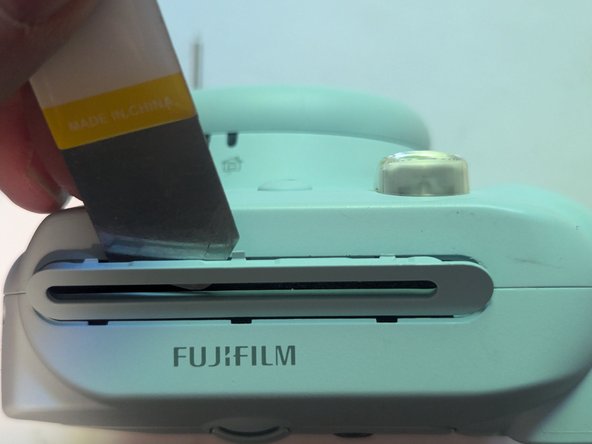

  10. Fujifilm Instax Mini 9 Camera Shell Replacement, Remove the Film Ejection Slot Cover: crwdns2935265:010crwdnd2935265:01crwdnd2935265:03crwdne2935265:0 Fujifilm Instax Mini 9 Camera Shell Replacement, Remove the Film Ejection Slot Cover: crwdns2935265:010crwdnd2935265:02crwdnd2935265:03crwdne2935265:0 Fujifilm Instax Mini 9 Camera Shell Replacement, Remove the Film Ejection Slot Cover: crwdns2935265:010crwdnd2935265:03crwdnd2935265:03crwdne2935265:0
    • The film eject slot cover hides one of the screws that need to be taken out to remove the camera shell.
    • The cover is held on with six clips, three on each side. Insert an opening tool and pry the cover off.

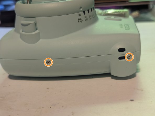

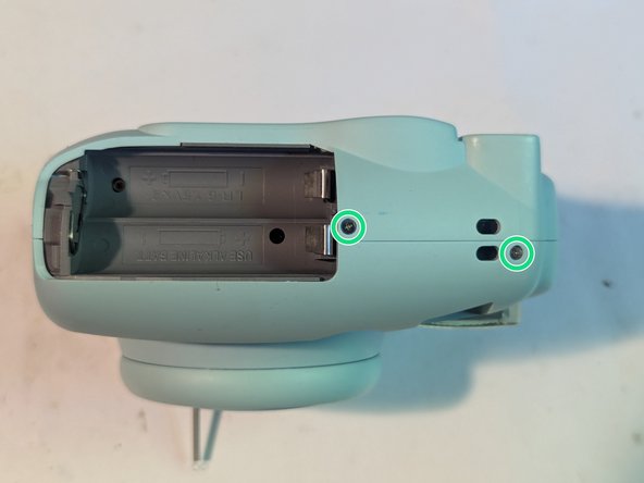

  12. Fujifilm Instax Mini 9 Camera Shell Replacement: crwdns2935265:012crwdnd2935265:01crwdnd2935265:02crwdne2935265:0 Fujifilm Instax Mini 9 Camera Shell Replacement: crwdns2935265:012crwdnd2935265:02crwdnd2935265:02crwdne2935265:0

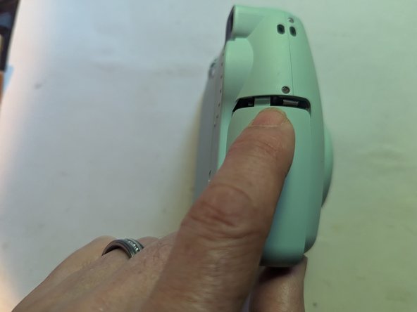

    • Take out two more screws on the bottom of the camera.
    • And finally, unscrew the last two screws from the left side of the camera, above the battery cover.

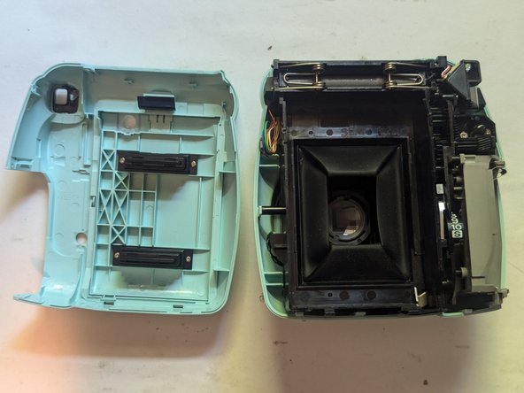

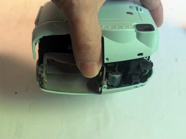

  13. Fujifilm Instax Mini 9 Camera Shell Replacement, Remove the Rear Cover: crwdns2935265:013crwdnd2935265:01crwdnd2935265:03crwdne2935265:0 Fujifilm Instax Mini 9 Camera Shell Replacement, Remove the Rear Cover: crwdns2935265:013crwdnd2935265:02crwdnd2935265:03crwdne2935265:0 Fujifilm Instax Mini 9 Camera Shell Replacement, Remove the Rear Cover: crwdns2935265:013crwdnd2935265:03crwdnd2935265:03crwdne2935265:0
    • Separate the halves by prying them apart with a thin opening tool.
    • From there, the rear cover can be lifted off.

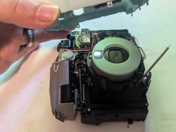

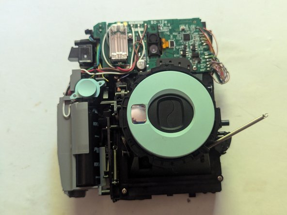

  14. Fujifilm Instax Mini 9 Camera Shell Replacement, Remove the Front Cover: crwdns2935265:014crwdnd2935265:01crwdnd2935265:03crwdne2935265:0 Fujifilm Instax Mini 9 Camera Shell Replacement, Remove the Front Cover: crwdns2935265:014crwdnd2935265:02crwdnd2935265:03crwdne2935265:0 Fujifilm Instax Mini 9 Camera Shell Replacement, Remove the Front Cover: crwdns2935265:014crwdnd2935265:03crwdnd2935265:03crwdne2935265:0
    • With the rear cover removed, flip the camera over and the front cover can simply be lifted off.
    • Note that there are three parts that may fall out when the front cover is removed; the shutter button, the right side strap backing, and the brightness adjustment dial return spring. Those parts and their proper placement are outlined on the next three pages.
    • During reassembly, be sure the brightness adjustment ring is installed on the front cover before placing the cover on the camera body. Due to interference from the tension spring, it cannot be installed once the front cover is in place.

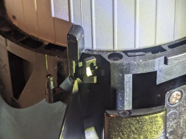

  15. Fujifilm Instax Mini 9 Camera Shell Replacement, Brightness Dial Return Spring: crwdns2935265:015crwdnd2935265:01crwdnd2935265:03crwdne2935265:0 Fujifilm Instax Mini 9 Camera Shell Replacement, Brightness Dial Return Spring: crwdns2935265:015crwdnd2935265:02crwdnd2935265:03crwdne2935265:0 Fujifilm Instax Mini 9 Camera Shell Replacement, Brightness Dial Return Spring: crwdns2935265:015crwdnd2935265:03crwdnd2935265:03crwdne2935265:0
    • Press the power on button to extend the camera lens.
    • The retainer for the brightness dial return spring is shown with the spring in its proper position.

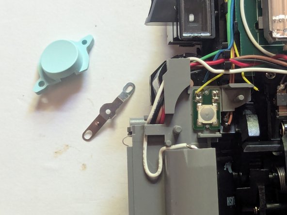

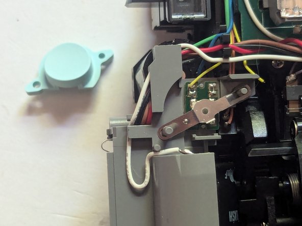

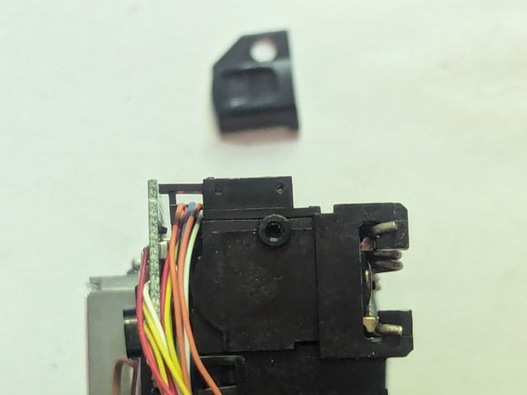

  16. Fujifilm Instax Mini 9 Camera Shell Replacement, Shutter Button: crwdns2935265:016crwdnd2935265:01crwdnd2935265:03crwdne2935265:0 Fujifilm Instax Mini 9 Camera Shell Replacement, Shutter Button: crwdns2935265:016crwdnd2935265:02crwdnd2935265:03crwdne2935265:0 Fujifilm Instax Mini 9 Camera Shell Replacement, Shutter Button: crwdns2935265:016crwdnd2935265:03crwdnd2935265:03crwdne2935265:0
    • The shutter button is shown in is proper position and orientation in this photo.
    • This next picture shows the metal button contact as it should be mounted.
    • Here is the camera with both parts removed. Since the only thing holding them in place is the front camera shell, they will easily fall off once the shell is removed.
