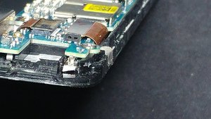

Real problem: the contact gauze connects to the antenna at the top, the contact pin presses on it near its bottom edge. There should be a tiny rubber pad under the lower part of the gauze. This was missing on mine, so the spring contact never made good pressure on the gauze, and over time wore the gauze away. I only discovered this after buying a broken G5 on eBay and comparing. I swapped phone backs to get it working.
I also proved this is the contact by re-assembling with a sliver of paper on the gauze to prevent contact - no GPS signal.
The missing rubber pad must have been a manufacturing error, I don't know if it affected a whole batch. Check out this area in the back of your phone, you may be able to see why there's a problem.

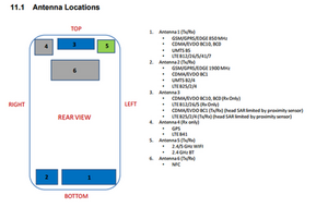

The diagram belo shows where the antennae are on the back of the G5. This is viewed from the back, where the GPS antenna is area 4. Looking from the front (i.e. looking at the back from the inside) it's at the top right.
Here's a photo of this area from the inside of the G5 back. There are two contacts in this area, circled in green and red.
I originally thought the antenna was the green one, as it's in the right location, and disrupting it seemed to stop GPS. However, further tests on another phone have proved to me that the main antenna contact is the red one, which connects to a rectangular pad on the motherboard. The pad is circled in red in this photo:
I suspect the green contact is a ground connection, as are other similar contacts around the back. Bad grounding can be expected to degrade the antenna efficiency, so the ground contacts are important too. I think this is what I was seeing initially.
So my conclusion is that good GPS reception depends on both a good ground connection in the corner, and a good connection to the antenna pad marked in red. About the only thing you can do to improve the pad's contact is to gently rub both surfaces to remove any oxidation. The tip of a spudger is probably the best tool.

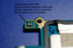

First of all, thanks Rick for putting us on the right track.
Now, I've had this problem on my device, and so I opened it and tested, seems that your first solution (the mesh) IS the correct one.
The other (flexible) connector on the PCB (the one that you updated to be it), is possibly not related to GPS.
Just to make some order, they BOTH connect to case metal (ground) which is very strange as I can not think why or how would it be used as an antenna. But!, powering the phone while opened, testing several pins which connects to the back, only 1 was found to be the pin for the GPS receiver.
This was tested with a thin wire connected and watching the reception on GPS test app.
Tested several times, each time yielded same result. Only the connector that mates with the mesh on the case (top right of back case when looking at it while phone opened) gave almost instant lock and strong reception.

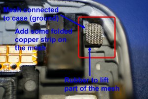

I'm including photos with remarks to make it hopefully clear:
Here you see the mesh in the top right, the other (green) connects to the flexible connector on PCB, possibly not related to GPS.
I used a piece of thin copper tape folded a few times and glued on one side to the earphone connector.

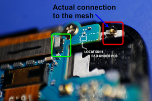

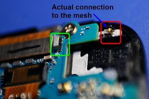

here you can see the actual pin (red) that connects to the mesh. It is not on the PCB itself, but connects later to underside of PCB (I guess LG decided not to stretch the PCB to the very edge, because it would have to be very thin and fragile, just a guess)
You can see the connector after I removed the PCB, again marked in red, it continues to the pad marked in orange, which I put again a folded piece of copper. This pad connects to the underside of PCB.
The underside of the PCB with the connector that mates with the pad.

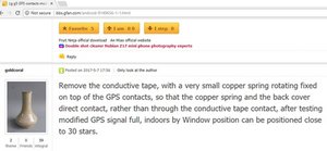

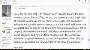

This is print screens of Chinese forum translated by google chrome translator. I can't copy paste link , the system recognizing it like spam.

I had previously put more mesh/foil at locations 1 and 2, and the GPS improved but it was not fully “functional”.
Locations 1 and 2 are what people talk about — but as Shlomsi  pointed out there is a Location 3.
Once I unscrewed and pried up the PCB and stuck some foil/mesh tape I was back in action!

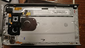

This may be useful - it shows along-side two different versions of the back cover of the G5 (H850). I noticed the differences whilst troubleshooting GPS problems. Swapping the backs between two phones fixed the issue in this case. There look to have been some design changes during production for these phones.
You seem to be able to buy new OEM backs on a popular online auction site, but I ended up getting a reliable fix by buying a used one for a little under £4 (approx USD $5).
This photo (click to enlarge - otherwise it’s difficult to see the detail I’m talking about) shows the phone screen and motherboard at the top, the replacement (working GPS) back next to it (centre of the photo), and finally the original (non-working-GPS) back at the bottom (sitting on top of and partly covering the working one).
The design differences in the working back (centre of photo) are:
  1. The square gauze to the left has been moved to the right of the photo, and sits partly directly on the aluminium phone back, and partly on a rubber pad (I tried making this mod on the old phone, but it wasn’t successful - that’s why the old gauze looks a bit battered and you can see some adhesive residue where I used double-sided tape to fix down a rubber pad).
  2. The brown/grey conductive pad (on the new back - in the centre of the photo) seems to come up a bit higher, and completely replaces the tiny PCB with the pad on which the old back has. The surface-mount component on that tiny PCB is probably a capacitor, because I can’t get a resistance measurement across it. The four vias (square pattern) that you can see on the tiny PCB measures zero-ohm to the metal of the case. On the new back the the brown/grey pad is zero-ohm to the metal of the case.
Just in this thread, you can see three different designs for the contact at the edge of the case, so this must have caused LG plenty of grief!

Update. When I broke my display again I used the opportunity and drilled a hole in the backcover, allowing me to attatch different antennas to the gps antenna connector. That brought no good results, but it ruined the backcover. So I used the old backcover again, but this time I took the PCB off as well and applied conducting silver to the point where the PCB touches the contact bridge in the display part, and after refitting the PCB I applied conducting silver to the point where the contact bridge touches the wire mesh in the backcover. Gps has been wonderful since then. So I dont think that the gps antenna in the backcover degrades, I guess that just the two contact points leading the signal from the antenna to the PCB are corroding.
Gold does not corrode. Perhaps there was a problem with the conducting mesh pad. Too much conducting silver also messes the antenna in the back cover up; so, be careful.
My GPS did not work after I replaced a cracked screen with screen assembly bought from Amazon. I followed all the write ups for suggested solutions. I was confused for a while by reading Rick Jones posting since my back cover had no mesh. So I ignored it assuming that some LG-5s may have slight variations in the design. What worked for me was the description from Shlomsi and Justin except I did not add any tapes. When I compared the contact (location 3 in red as shown in Justin's posting) with the contact on my old screen it was sitting much lower and below the level of the rubber pieces, which I guessed was not allowing it to make the connection to the back cover when assembled. If you look under a magnifying glass you will find it to be a tiny cantilever spring like contact. So I very gently bent it up to where it was above the level of the rubber pieces. Now the GPS works fine. Thanks to all for descriptions and specially to those who posted the pictures. It helps a lot to follow the different attempts.
I also touched up all metal contacts on the PCB and the back cover with a cue tip lightly damped with isoprophyl alcohol to clean out any oil left over by handling.

you are right. i got the gps working with back case off and it seemed like it really got it working, because i could get gps lock on as soon as I touched the corner pin with piece of copper wite, i tried to pack it back in with the handing wire but then lost the signal. then i reopened it and even the wire trick stopped working so now really sick of fixing it.
