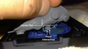

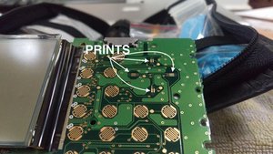

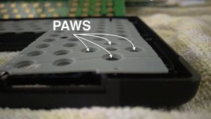

The conductive "paws" on the silicone button membrane where not landing flat onto the logic "prints" on the circuitboard.

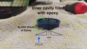

This is do the design of the D-pad button. It pivots about the origin, therefore "tilting" the "rubber button/paw", which causes the "paw" to not land flat. Landing flat is important to cause continuity across the "print".
Thus,
By modifying the D-pad, one can cause the "paw" to land flat. The idea is to "pitch" the buttons interaction with the D-pad, so that, by the time the "paw" rotates down, it lands flat on the "print".
  • Last note: Applying small amounts of silicone grease (Plumbing Section), allows the rubber "paw/buttons" to slip in the interaction against the epoxy and slop into its natural flat position. Silicone grease will not eat the plastic like normal grease would.
** The silicone grease is to go between the epoxy and rubber pad. No contaminates should be on the chip side at all.

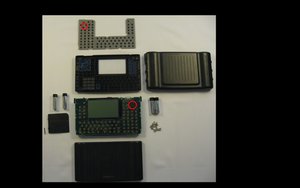

Here is a link to the ifixit repair guide for the device.
Here is an image taken from the repair guide. I have highlighted which contacts need to be cleaned, both on the board and on the rubber pad. (The rubber pad contacts have a conductive coating which bridges across the contacts on the board, when the button is pressed down completing the electrical circuit)
Use a Q-Tip moistened with IPA 90%+ (Isopropyl Alcohol - available at most pharmacies - do not use 'rubbing alcohol' as it is not as effective)
(click on image to enlarge for better viewing)
Take note of the caution issued at Step 9 in the ifixit teardown instructions

The blue cursor button is designed incorrectly. I developed a method to correct for the aberrations. It works wonderfully now.
(If I have time, I might open the calculator back up in two weeks and show pictures of what was done. ) Should I wait till then to post my answer?
