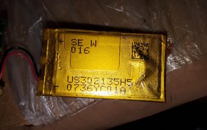

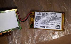

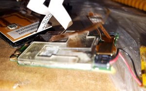

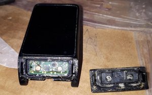

I had to open my Vivoactive HR because it wad died, what I saw it was water inside device :(
Now I know that it is no super easy way to open this Garmin.

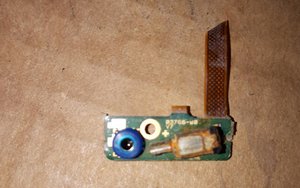

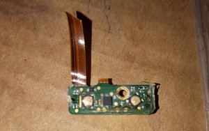

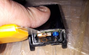

1st. you have to unglued plastic part where buttons sits
2nd. using this hole (buttons whole) you should gently push screen using something like screw
  • be careful with electric tapes (there are few) it is easy to broken (tear) using only a little force
  • there is only 1 screw on button board
Maybe my photos will help anybody to repair this Garmin.
So I have a vivoactive hr and yes a crack screen n unresponsive to touch too. Opened it up( direct from screen) and it wasn’t that hard too, but I really hope they start selling the screen so maybe one day I can replace it.
How did you get the screen off? Trying to get it off without completely destroying the unit.
It’s being hold down by adhesive tape so use heat
