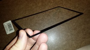

I replaced the touch screen and that appears to have fixed my problems. I did leave off the plastic bezel that was on top of the old touch screen. Does the gamepad need that? Here is a pic of the bezel that was sitting on top of the old touch screen.
Could you upload a foto of the bezel?
I added a picture of the bezel.
I do not know Is the screen sitting thigh enough in the case or is it loose?
It's not loose. I think that plastic piece is just to help protect the edges of the screen.
