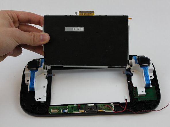

    1. Wii U GamePad LCD Display Replacement, LCD Display: crwdns2935265:019crwdnd2935265:01crwdnd2935265:02crwdne2935265:0 Wii U GamePad LCD Display Replacement, LCD Display: crwdns2935265:019crwdnd2935265:02crwdnd2935265:02crwdne2935265:0
      • Remove the four 5.1mm screws using Phillips size #0 screwdriver.
      • Pull the white and black cables away from the display case.
    2. Wii U GamePad LCD Display Replacement: crwdns2935265:020crwdnd2935265:01crwdnd2935265:02crwdne2935265:0 Wii U GamePad LCD Display Replacement: crwdns2935265:020crwdnd2935265:02crwdnd2935265:02crwdne2935265:0
      • Lift and remove the grey display case with your fingers.
    3. Wii U GamePad LCD Display Replacement: crwdns2935265:021crwdnd2935265:01crwdnd2935265:02crwdne2935265:0 Wii U GamePad LCD Display Replacement: crwdns2935265:021crwdnd2935265:02crwdnd2935265:02crwdne2935265:0
      • Gently with your fingers, press on the front of the display and it will lift up.
      • Remove the display with your fingers.

In step 14 - what does the small gray ribbon do? The replacement LCD display that I got in the mail did not have it.
Stacey Hoggard - crwdns2934203:0crwdne2934203:0 crwdns2950251:0crwdne2950251:0
Its the touch screen cable. The screen I ordered did not come with one. I had to carefully remove it from my broken display and put it on the new one. Thankfully the touchscreen still works for me.
