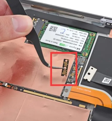

Are you using an original charger? Did you make sure the pin layer thingy for the battery and LCD connector are there and are not upside down?
had to purchase a new charger, it is a microsoft brand surface pro 3 charger, as far as im aware there's only one pin layer for the LCD connector not for the battery. if i am wrong let me know.
Actually the battery one does. Because the battery connector and LCD connector on the board both have a bridge connector that is supposed to be placed.

The battery one uses a different one so they are not the same notches and pinouts.
not seeing a picture there from your link, but i checked it out on ebay, will check tomorrow if the part is there or lying around somewhere, thank you.

I was able to find the solution to my battery not detected problem. There is a small piece that goes between the battery ribbon and the board connection. After disconnecting the LCD/glass, that's when I noticed the extra little piece that should have gone in. Thankfully, I saved everything from the repair, reinstalled that piece and had no problem with battery detection after that. Hope this helps.
Can you send a photo of that small piece?
I'll be repairing one on Monday and I'll try to send it then.
It's just a bridge metal plastic connector that goes between the battery connector pins on the logic board and the battery ribbon cable itself.
The LCD connector on the logic board has one too.
Funnily enough I might actually have spares of this from a few cracked surface pro 3s with no screen.
