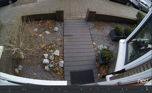

I had the same problem and decided to go for cutting the cable. I first bought an USB extension cable to test the procedure. And you know what? Nest Outdoor Cam only uses the red and black power wires and not the green and white data wires. So I cut the cable, drilled an 8 mm hole and inside the house joined the red and black wires again. The cam works like a charm!
