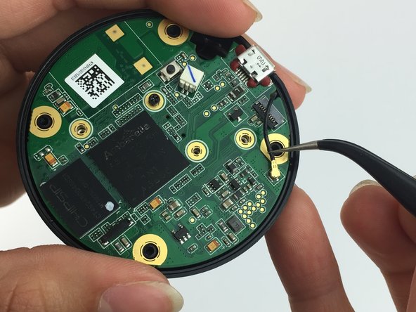

    • Remove the four 6 mm screws from the back panel with the JIS 000 screwdriver.
    • We suggest designated areas to keep track of all screws.
  2. Nest Cam Motherboard Replacement: crwdns2935265:02crwdnd2935265:01crwdnd2935265:03crwdne2935265:0 Nest Cam Motherboard Replacement: crwdns2935265:02crwdnd2935265:02crwdnd2935265:03crwdne2935265:0 Nest Cam Motherboard Replacement: crwdns2935265:02crwdnd2935265:03crwdnd2935265:03crwdne2935265:0
    • Open the back panel completely to expose the inside of the Nest Cam.
    • Using the tweezers, disconnect the red and black mic cable from the motherboard.
  3. Nest Cam Motherboard Replacement: crwdns2935265:03crwdnd2935265:01crwdnd2935265:02crwdne2935265:0 Nest Cam Motherboard Replacement: crwdns2935265:03crwdnd2935265:02crwdnd2935265:02crwdne2935265:0
    • Remove the two 4 mm screws with the JIS 000 screwdriver from the center.
    • Disconnect the black Wi-Fi cable from the motherboard with the tweezers.

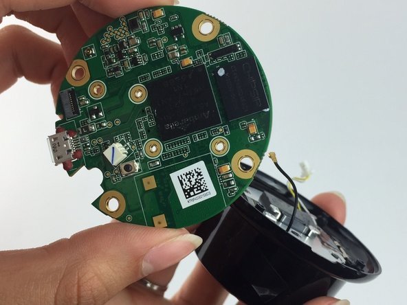

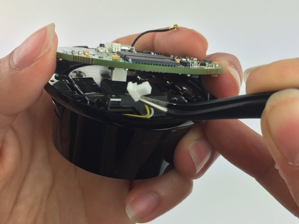

  4. Nest Cam Motherboard Replacement: crwdns2935265:04crwdnd2935265:01crwdnd2935265:03crwdne2935265:0 Nest Cam Motherboard Replacement: crwdns2935265:04crwdnd2935265:02crwdnd2935265:03crwdne2935265:0 Nest Cam Motherboard Replacement: crwdns2935265:04crwdnd2935265:03crwdnd2935265:03crwdne2935265:0
    • Use a plastic spudger to lift the motherboard slightly up to expose and disconnect the white cable and the yellow/white IR cable with tweezers.
    • Then use the spudger or a finger to lift the motherboard completely up and off.
    • When installing the new motherboard ensure that all wires are reconnected before securing.
