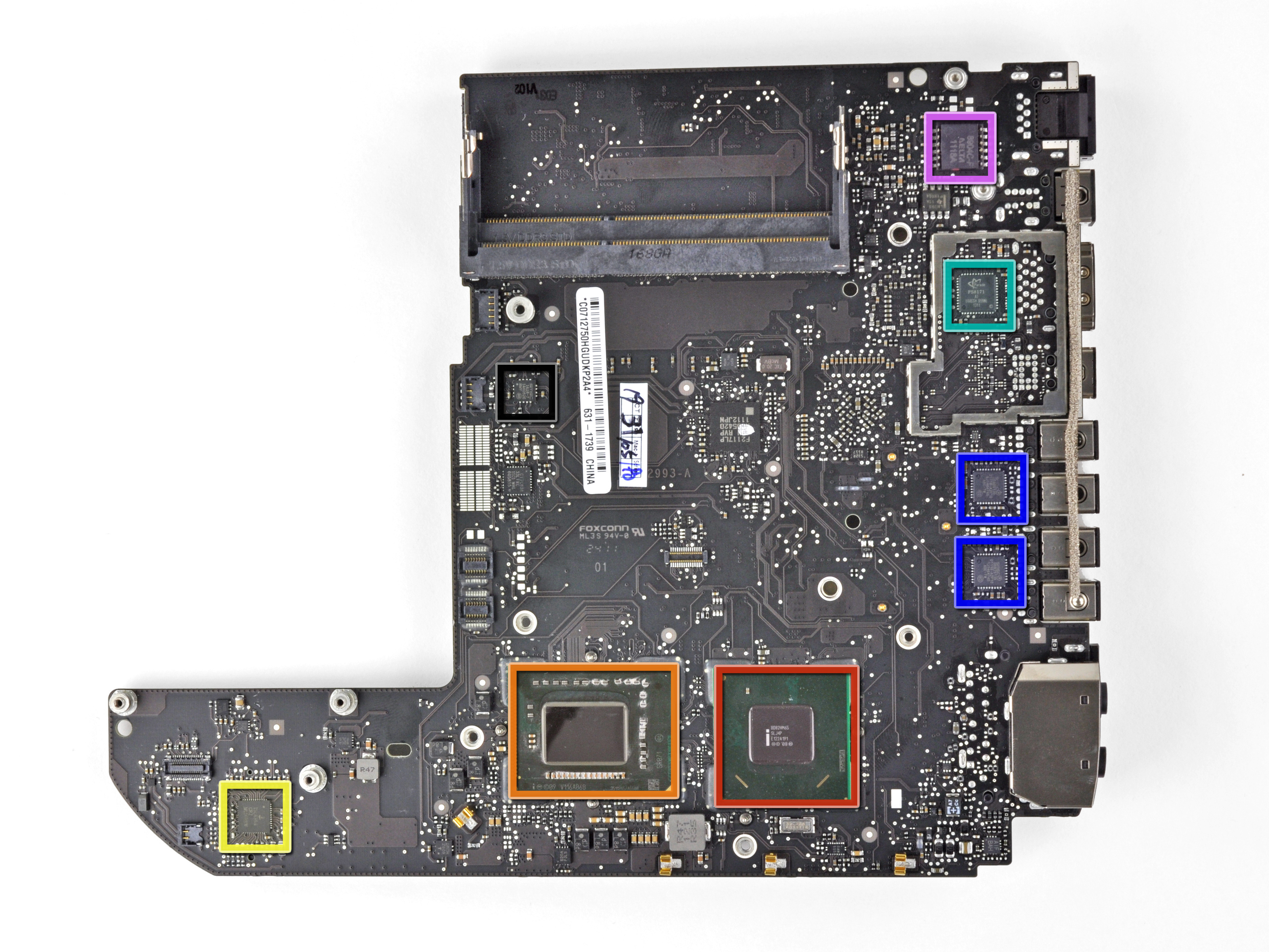

I recently purchased a mac mini mid 2011 on the cheap because it came without a harddrive.
Its currently running the macOS Sierra public beta off a 2tb external hdd which is working surprisingly well however the fan is spinning at full blast which is generating alot of exhaust noise.
Ive opened it up and noticed that the sata cable that connects to the internal drive is also missing.
My question is, Would replacing this cable and installing an internal HDD fix the fan issue or does the fan itself need to be replaced?
Ive tried using smc fan control and similar apps to no avail and get a RPM reading of 0 from the fan.
Ive also run AHT and returned the following error: "4M0T/1/40000002: Exhaust - 0"
Many thanks in advance for replies.
Sounds like someone broke a component on the logic board when they were in the system.
The logic board has a small section sticking out at the front of the board (you take the board out from the back) which in the process of installing can snap off one of the components. The part is part of the fans tach logic has come off or the fan socket was damaged (on the far left in the image)
Take the board out and compare it to this image: Mac Mini Logic board.
