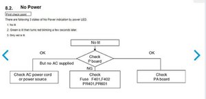

Here’s an image taken from the service manual for the TV showing the No Power Troubleshooting flowchart which is a good place to start
(click on image to enlarge for better viewing)
You will need a DMM (digital multimeter) and know how to use it to test if the fuses on the P board are OK.
Use the DMM’s Ohmmeter function to test if the fuses are OK. Do this with the power totally disconnected from the TV. The schematic of the P board is to be found on p.81 of the manual.
Also use the Ohmmeter to test the continuity of all the wires in the power cord from the pins in the plug to the other end of the cable in case it is a fractured cord.
