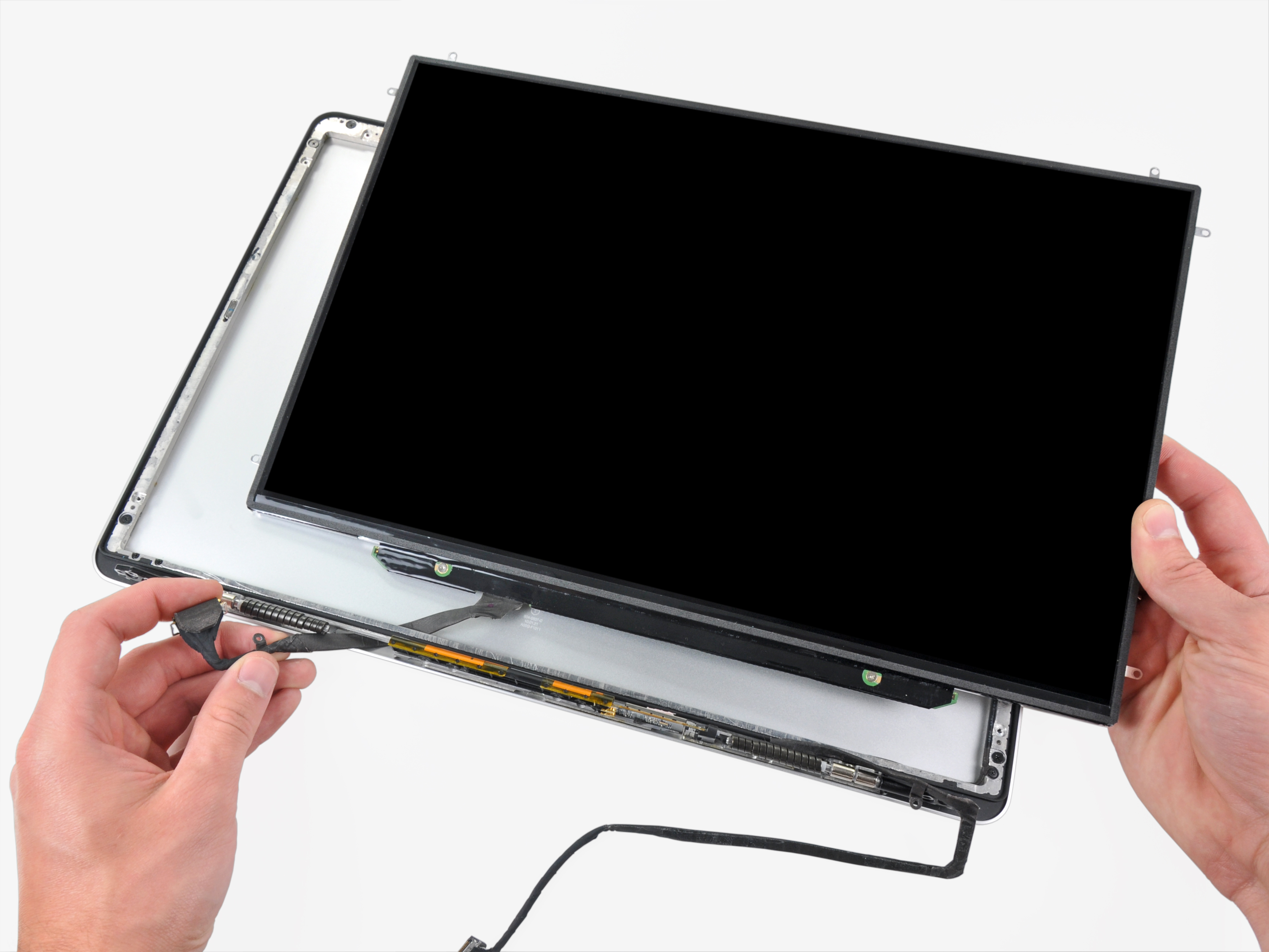

The back casing of the MBP is coming off and I have currently secured it with tape, but I am not sure on how to get a permanent fix.
It looks like this:
I am totally unaware of what to do. The apple store has said the machine is vintage and are refusing to fix it. I have spoken to a 3rd party apple repair specialists requesting anywhere from $439 to $1349. I do not want to but a new one. All I want is a permanent fix for the issue.
Does the display still work? Where do you live? With those kind of prices, I would guess Manhattan. Are those prices in US Dollars. I've done this repair several times. It's a fault in the frame (it breaks) about an inch up from the bottom of the display. It's a design flaw. Repair involves both repairing the frame and epoxy building up the support. But I have not had one fail after repair.
how do you go about repairing the actually frame at that failure point?

First, are you up to doing this your self?
Review this IFIXIT guide on what it will take to open your system and take the lid assembly off: MacBook Pro 15" Unibody Mid 2009 LCD Replacement. Here we need to get to the back side of the case (behind the LCD) as I suspect the screws which hold the mid frame have either loosened up or striped the holes. If stripped you can use some foaming urethane glue to glue the mid frame to the cover. Here's an image of the area so you can see what I'm talking about: Inside Lid Assembly. Note the large black head screws.
The other option here is to replace the complete assembly. You should be able to buy a used unit.
