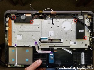

These did not help. The keyboard is under the motherboard and there is no obvious way to get to it that I could figure out after removing the bottom cover.
I should add that the quick fix did work at one point for me but now the same set of keys don't work even after unplugging/plugging the cable. I got a replacement keyboard but there are no instructions that I could find for a keyboard like this where it's under a solid bezel. If anyone knows what to do please answer.
Satellite radius p55w-B5224 keyboard replacement I managed to do it. It is not easy!
Toshiba Satellite Radius P55W keyboard is attached to the top case. In order to replace Toshiba Satellite Radius P55W keyboard it's necessary to remove the motherboard.
Here's complete Toshiba Satellite P55W disassembly guide.
