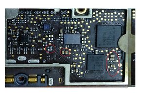

@touchwireless in the red circle most to the right in your picture, there seems to be a small component, possibly a resistor bridging two capacitors C3106 and C3108. Those 2 caps are on an important line shooting out from a touch IC. Remove that component and see if that solves it. Unless it is an artifact from the picture...
Here, that small guy in the middle of this circle, the only vertically positioned component:

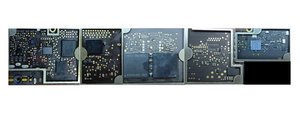

here is the pic for the logic board I worked on
I'll look at my schematics and get back to you. It does seem like you bridged something unless this is due to the bad image quality.
Can you add a high-resolution close-up picture of the area circled in red?

Yes something is not right. You seem to have a component shorting two caps. They are on the same line, but it could be shorting them to ground and causing this. You need to remove it.
here is the picture marked with "A" and "B" could you please tell me which one to remove?
@touchwireless check the picture I added last.
