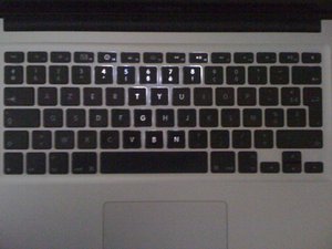

Hi, is it possible to wash the key under the transparent film? I've a macbook pro unibody late 08 mid 09 and i think it's the same kayboard (but i've the backlight). I've put a coffé in my keyboard and 3key do not respond and my backlight is off exept under the "T" "Y" and "6" and arroud key (see image attach).
Can I repair my key and my backlight?
I've my physical click of my trackpad broken too.
Thanks :).
