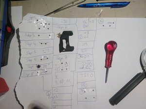

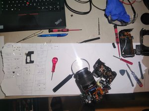

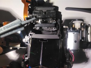

Here are the pictures.
Here you see my plastic spudger pointing at the ploppy lens.
If you wonder what that piece of paper with numbers and holes is: I put the screws through a piece of paper labeled with each "step" and oriented like on the step picture. Safeguarded with tape. That way, I do not lose screws and won't mix up the different lenghts.
