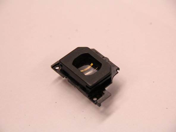

  11. Canon EOS Rebel T2i Eyepiece Replacement, Eyepiece: crwdns2935265:011crwdnd2935265:01crwdnd2935265:02crwdne2935265:0 Canon EOS Rebel T2i Eyepiece Replacement, Eyepiece: crwdns2935265:011crwdnd2935265:02crwdnd2935265:02crwdne2935265:0
    • Remove the red wire that travels across the mirror box.
  12. Canon EOS Rebel T2i Eyepiece Replacement: crwdns2935265:012crwdnd2935265:01crwdnd2935265:01crwdne2935265:0
    • Remove the following screws holding the mirror box in place:
    • Four M1.7x4.5mm Phillips #000 screws
  13. Canon EOS Rebel T2i Eyepiece Replacement: crwdns2935265:013crwdnd2935265:01crwdnd2935265:01crwdne2935265:0
    • Remove three JIS #000 screws to disconnect the ribbon mount assembly
  14. Canon EOS Rebel T2i Eyepiece Replacement: crwdns2935265:014crwdnd2935265:01crwdnd2935265:02crwdne2935265:0 Canon EOS Rebel T2i Eyepiece Replacement: crwdns2935265:014crwdnd2935265:02crwdnd2935265:02crwdne2935265:0

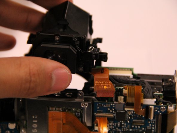

    • Now that the top assembly is free, this exposes another screw on the right side of the mirror box.
    • Remove the following screw:
    • One M2.0x4.3mm JIS #000 screw
    • Remove the orange ribbon cable.
  15. Canon EOS Rebel T2i Eyepiece Replacement: crwdns2935265:015crwdnd2935265:01crwdnd2935265:01crwdne2935265:0
    • Remove the viewfinder assembly from the camera. The screws that hold the eyepiece in place are accessible. Remove these three JIS #000 screws from the rear face of the eyepiece. Two screws are located at the bottom and one screw is located on top.
  16. Canon EOS Rebel T2i Eyepiece Replacement: crwdns2935265:016crwdnd2935265:01crwdnd2935265:02crwdne2935265:0 Canon EOS Rebel T2i Eyepiece Replacement: crwdns2935265:016crwdnd2935265:02crwdnd2935265:02crwdne2935265:0
    • With the screws removed, the eyepiece can easily be pulled free.

I used this guide to fix my 600D (Rebel T3i), and it worked like a charm.
The middle lens of my viewfinder had popped out of its plastic holder. it is now back in place, thanks to this guide.
I have added a couple of marker, to make it just that little bit easier to spot the screws and ribbon cables.
Thanks again!
