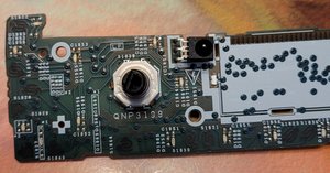

My Pioneer VSX-D608 receiver (from 1999!) is having a small issue with its volume knob. When I twist the knob, sometimes the volume increases a little and then stops, sometimes it will go the opposite direction, and sometimes it does not change whatsoever. This is a video of the behavior. It seems random, but I can get it sometimes to adjust correctly if I twist the very, very slow. Adjusting the volume with the remote works fine, audio/video functions work fine, everything but the volume dial works perfectly. Is there anything I can do? Or am I stuck with the remote to change the volume?

Hi,
The volume control 'encoder' is probably either faulty or dirty.
Try this first, (if you want to).
Disconnect the power from your receiver. Remove the top cover on your VSX-D608. Remove and pull out the black plastic knob (volume control) located on the front of your receiver. Look behind the volume control and you'll see a small board with the encoder mounted on it. Undo the screws holding the board and gently pull out the board. Gently use a small flat head screw driver and push/pry (be careful, you do not want to break them) away the 4 lugs that are holding the top cover on the encoder in place. Then gently pull out the knob which separates the assembly. Using an electronics contact cleaner spray (this can be purchased from electronics stores, do not use WD-40 or similar water displacement and lubricating products as these leave residues), spray and gently clean the inside of the encoder. Be very careful not to bend the small fingers located inside the unit. Sometimes there is some 'gunk' inside that is hard to clean so you need to use the cleaner and spray a few times. When dry, install the volume control back and push the 4 small lugs back into place. Rotate the control back and forth to ensure it moves smoothly. Install the board back into place, replace the top cover on the unit and plug the unit back in. Test it to make sure it works correctly.
If the above seems a bit daunting , buy a new encoder part # ASX7004 (not 100% sure on this point as cannot find out exactly but if AWX7386 is stamped on the encoder it is no longer available and the ASX7004 is the replacement for it. (AWX7836 is the part # used on VSX model # before and after yours, so I made an assumption about your as I couldn't find anything about your particular part) If there is a different number stamped on the encoder 'Google' it to get the correct part). Here is a link, there are others but nearly all say 'out of stock' http://alltronicmarketplace.com.sg/asx70... You'll have to desolder the encoder from the board assembly and then solder in the new one. The link also shows what it looks like.

Part # ASX7004 is no longer available from Pioneer. It is a 24 pulse-per-rotation rotary encoder. An equivalent part is Bourns PEC16-4025F-N0024 available from DigiKey for $2.08 + shipping (Canadian)

Cleaning the encoder worked great, thanks!
Thnx a lot! Very easy even for someone with very little technical skills.
Thank you both. I just followed the directions to fix mine as well
Worked like a charm!

If you know how to unsolder/solder this is a 10 minute repair. Here is the original part I removed and the Bourns replacement which actually fits better than the original:

The volume control on my Pioneer MVH-S312BT has been giving me fits for quite a while now. I ordered a Bourns PEC16-4025F-N0024 Rotary Encoder from Digi-Key only to find out it won't fit my radio. I wish I knew what the correct part would be to fix my situation. Thanks in advance for any help anyone can offer. I've tried washing it out with some mass air flow sensor cleaner that helps but it's not a fix.
The picture above shows my control compared to the Bourns PEC16-4025F-N0024
Update (10/01/2022)
Spraying the cleaner in the volume control wasn't working as well as it did at first and not knowing anyway to find a replacement, I decided to try unsoldering it and following the fix from the YouTube video I posted above. That seems to have worked. I wiped the inside of the control with some rubbing alcohol and just slightly raised the wiper blades a little before putting it back together and soldering it back in. That seems to have fixed my problem. For how long I won't know for awhile.
Thanks for all the suggestions and help from everyone here that offered.
Thanks for the links. Looks like with the prices they're charging, it would cost about $20 by the time shipping was added.
I might have to do what this YouTube video shows - un-solder the volume control from the board so I can open it up and clean the contact area really good and see what happens.
